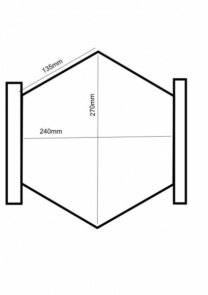

Here are rough outside dimensions for the bag bellows I got used for my Horseman 4x5, which also fits the Sinar 4x5s. There are interior standing seams of about 3mm on the inside of the bellows along each 'edge'. These dimensions are with the cloth stretched flat along each dimension when measured. This isn't a pattern, but might help you dimension your own.
The seams run from one front standard corner to the corresponding rear standard corner. There are no seams parallel to the standards.
Lee

Ian, Thanks, The springy thing in the middle may take a little creativity, but I think I have an idea. If it works I will post then. Anything else you can think of will help drawings, pictures (archphoto that would be great) and thanks Lee for the measurements and drawing. I will have to compare them to the Toyo view.
I am not a metal worker, but I am a woodworker, so I may end up trying to make something to attach the bellows to. It doesn't seem like it would be that hard, but I will need to closely inspect my camera and see the details of what the bellows are on now. I have considered making a middle standard so I could also use a double bellows for long lenses. Although, I think I might be getting well beyond my field of knowledge with that one. I have not had much luck finding spare parts for this camera (affordable), but my time seems to not be worth so much these days and therefore cheaper.
