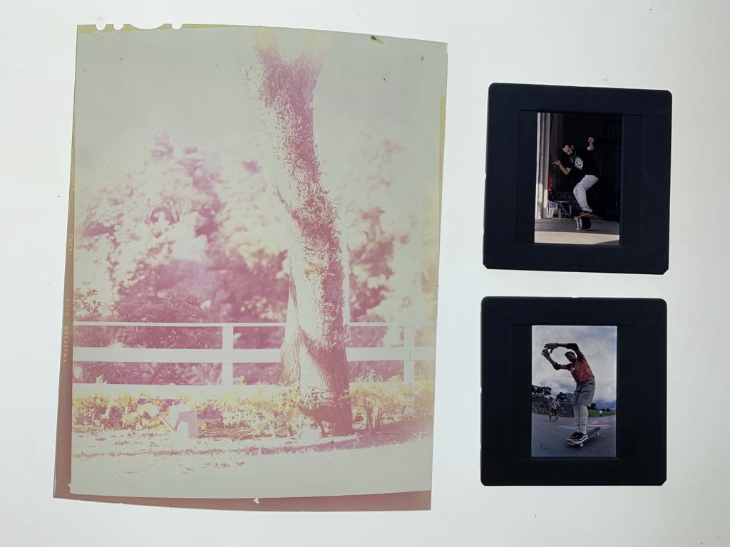

So, here they are, in all their dry glory:
The 35mm slides are good enough. The top one a little underexposed and the bottom one really good. The 4x5” one has no cyan in it and the yellow layer is almost totally gone too, leaving this magenta image.
I don’t think this film can be “salvaged”. I’m just gonna trash it, after fixing the silver out with some old fixer.

I may try it. I’ve been through that thread before, but don’t remember anything about fogged films. I’ll have to read it all again.
Strange thing the red sensitive layer (which will give cyan pigments in the final image) is the most fogged. I am not sure if it’s the outermost layer...
The red sensitive layer might be the the most likely to be affected by infrared/heat.
