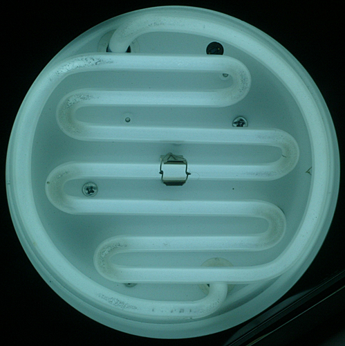

Boy do I feel stupid.
It finally dawned on me that I've been having to burn in all my prints from 4x5 negs in the same areas. So I got suspicious about an uneven light source. I focused the bare lamp onto my baseboard and grabbed the lamp housing and rotated it and could clearly see dark patches following the rotation. Only then did I lift the housing and actually look at the lamp.
Let's just say that I was jumping trough needless hoops printing...and a lot of print recipes will be out the window now.
The upside is that I'd already ordered a new D2-HI-V54 from Aristo for unrelated reasons. Yeah, I know...those print recipes are out the window anyway.
I never noticed this with the 6x6 negs because the problem isn't apparent in the center of the lamp.
My lamp must be about 19 years old. If yours is of a similar vintage you may want to check and see if it looks anything like this one...
(note: what you see is all on the inside of the tube, not the exterior surface)

What if you used another layer of diffuser (plexi) underneath - surely you could get it CLOSE to even... (just as a purely academic argument! - certainly it's time to put the old one out to pasture - but if you needed a quick fix...!)
Thought of that and thought of actually moving the lamp further from the diffuser as well. Bottom line is that I'd already coincidentally ordered its replacement.

Right. makes loads of sense. I only responded because I had similar issues on my mind. I just converted my DeVere dichro to cold light, and was messing around with diffusion (I didn't have a decent diffuser - and found that orbital-sanded double plies of clear plexi didn't do a whole lot to get rid of the 'grid' pattern).

My thought is to chuck it. Life (and darkroom time) is way to precious to waste on substandard equipment and I would go as far to say that in this day and age you should only be using the best, because the best is really cheap now that no one wants it.

I had the same experience with a cold light, but was lucky to discover the problem right away because the first print I made was of a wide waterfall. The negatives exposure was quite long, so there were large areas of even high values which showed bands of dark and light print values.
It took some head scratching but I got a slam-dunk diagnosis with the following test. Focus a negative in the enlarger then remove it. Place a piece paper in the easle and give it enough exposure to print as a lightish grey at a bit more contrast than 'normal', then process the paper. In a perfect world the paper should be of a smooth, even tone from edge to edge and corner to corner.
I was shocked at how uneven the print was! As suggested earlier, a piece of plexiglass above the diffusion disc did the trick but came at a cost...it lengthened exposure times and created fall-off at the corners which had to be compensated for while printing, but at least it was smooth.
I'm getting a new light source soon, and that test is the very first thing the light is going to do.

Well, my new lamp is installed. It was a breeze to do, though I was very nervous about the little bit of flexing it went through to get it into place. It's actually the second D2-HI-V54 that was shipped. The first broke in transit which is surprising because I can't imagine that it could have been packed any better than it was. Aristo sent a replacement promptly and asked no questions.
Some observations:
The "HI" lamp is SO much brighter. It now stabilizes at "L" whereas the old lamp stabilized at "F" on the Zone VI stabilizer.
The V54 is SO much more cyan than the old lamp with corrective yellow filter. I knew any previous print recipes wold be irrelevent but it's astonishing how the yellow and magenta created with split grade filters are so much more yellow and so much more magenta.
I'm looking forward to being at square one.
The light is still a little uneven, though much, much less so. If I focus the round light beam onto the baseboard, I can still detect variations if I rotate the lamp housing. Most of the dimmer areas would be masked by the negative carrier. I may still think about adding another diffusion disk.

In principle, at least, you could make a mask, using some reasonably linear film/developer combination. I have seen reference to this before, but never tried it myself. My guess is that it would take a lot of neutral density between the lamp and a sheet of film (possibly litho stock) to get a manageably short exposure, and then development to a fairly low density. (It is my understanding that this was once done for large contact printers used for things like mass-production of architectural photos.)
This went right over my head. Sorry. What problem would such a mask address?

jstraw: Sorry--I should have been more clear.
If you make a "contact print" of your lamphouse onto film, the brighter areas of the lamphouse will be darker on the film, and the less bright portions will be lower in density. In principle, putting this "mask" in registration below the lamphouse during printing will even out the exposure across the field, because the brightest parts of the lamp will be behind the darkest parts of the mask, and vice-versa. Getting the right density and contrast is the tricky part, and as I said, I have not tried it myself.
The whole process is comparable to the making of positive and negative contact masks for correcting density and contrast; at one time, this was common enough that Kodak made a film---Pan Masking Film, I believe---specifically for doing this with large-format color images.

It's curious, J. RIGHT after you made that post and I'd responded... I ran into the same problem with my new cold light. I'd done some pretty major modifications to the housing (cutting) to get it to fit into my lamphouse. After the first several prints - I started noticing the same thing as you had. It was corrected by raising up the cathode (tube) into the shell in what is probably it's proper position - about half an inch up. Before it was sitting DIRECTLY on the plexi diffuser.

Mine has a metal spring clip in the center of the housing that holds the tube...once the tube is snapped into that, it can't go any higher. If I need it higher than that, I'd need to work out a way to raise the whole housing...which I can do relative to the neg by extending the top bellows a bit...but that won't raise it relative to the diffuser. that would require some creativity.

Zone VI head, Aristo won't touch it. I'm lucky the lamp even fits. Aristo SWEARS they didn't OEM the Zone VI heads. I don't believe them...that's another story. :tongue:
The Zone VI stabilizer is a dimmer only better...so I can turn the light way down if I need to.
The "anomalies" are in the shape of the tube. I think the issue is this...the tube sits so close to the negative that if the negative is in focus, the tube can't ever be completely out of focus. I suspect that the only real solutions would be either to get the tube further from the focal plane of the negative (which may cause vignetting) or to increase diffusion.

Distance lamp - condenser is not the same for different negative size. Also it is not bad practice to place a tracing paper (one like mat focusing glass on the view camera) between the lamp and the condenser (after proper lamp position is found).
www.Leica-R.com
Cold light heads have no condenser. The distance between a cold light source and the negative does not change for different formats. Cold light heads such as mine incorporate a sheet of white plexiglas as a diffusing element. A sheet of tracing paper would contribute nothing.
