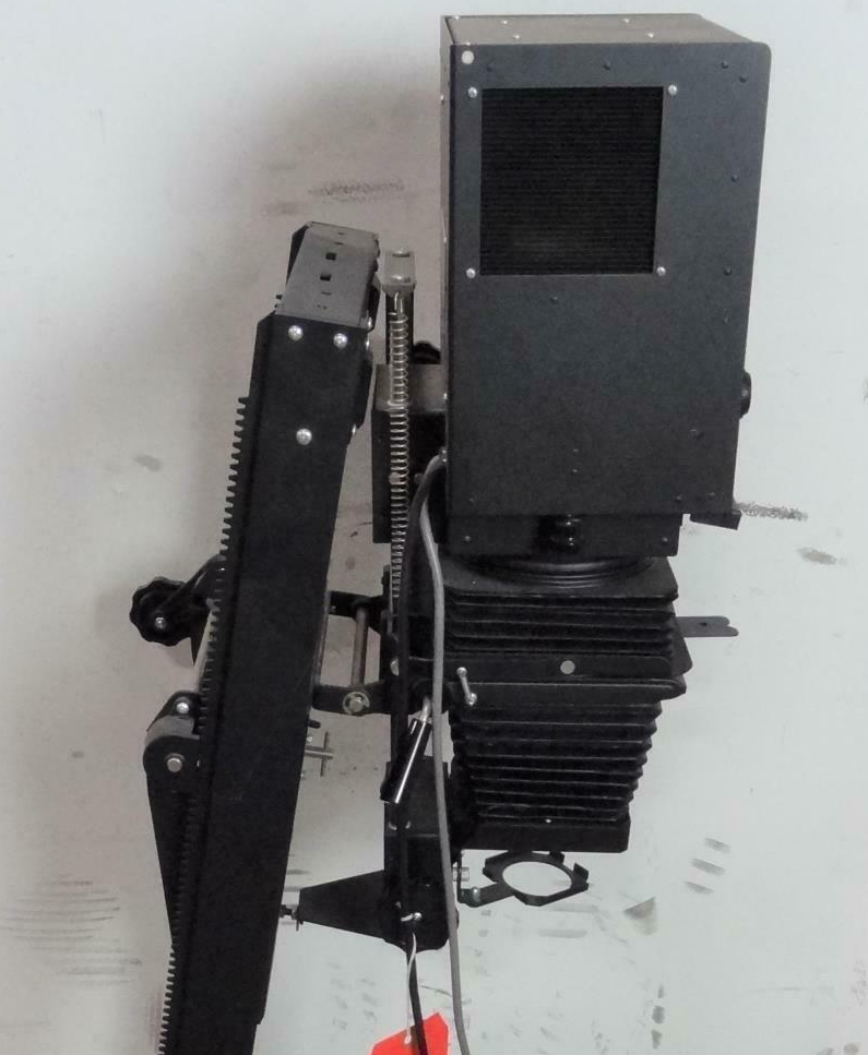

The issue is that the top of the Dual Dichro head is striking the horizontal top crossmember of the frame assembly. limiting the vertical rise of the central carriage! That ought not be occurring, but since I am not an owner of that combination, I cannot comment on what is not properly assembled in your situation. The XL frame is ordinarily supposed to rise high enough to permit 19X enlargement with 50mm lens (about 18" x 27" print)
MattKing
Apr 24, 2005
53,160
Delta, BC Canada
Play close attention to the side view in that eBay listing.
This one (cropped).
How does the side view of yours compare?
wiltw
Oct 4, 2008
6,455
SF Bay area
This one (cropped).
It might be a good idea for OP to take a photo of the side view of his enlarger with a digital camera so he can post the photo for us to look at, to comment on what needs to be remedied!

how much did they change when they switch to the black painted models? ill get the photo up, wont be instant but the cropped photo enlarger, its as if the hinge bracket sticks out twice as far.

one photo actually DOES hint that the enlarger is tipped backwards slightly,,,, but that means i have to dig a square out of the garage tomorrow and rob a piece of glass from a picture and do the setup testing.. Sometimes i dont envy myself.
Took the dichro head off, took the moment to clean inside and put it back together. Everything is good as the bottom hole in the dichro head is designed to rest directly upon the ledge just above the beseler labelled trap door for the heat glass to fit into.
But somehow the enlarger can go to 5.5" on the height scale until its directly touching the corner brackets at the top rail. Rather interesting.
The way the back support is designed, that shouldn't happen unless the enlarger is tipped back too much. As the plate holding the head moves up on the rails, it's also staying farther out towards the user because of the slant.

i will be checking the alignment tomorrow, but i when i took the dichro head off, i could get the enlarger body all of the way to the end of the scale.

At the bottom of the carriage assembly there is an adjustment screw installed in a bracket. Either the adjustment is way off or the bracket could be bent- or both. In any case it would not be difficult to remedy. It is annoying that photos from phones have to be resized to post on this site, but I think it would be easier for you to resize a photo (plenty of free programs and apps available) and post a pic from a similar vantage point to Matt’s posting to get to a solution. You’ve already spent days on something a photo would likely solve in minutes.

my cellphone doesnt connect with my computer, but my dslr takes a decent photo, but the jpegs are roughly 4 mb in size. email would work
