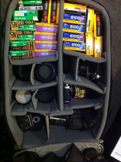

Nuff: the ThinkTank seems to be 25L if you multiply out the internal dimensions. It'd probably be 30 if it didn't have the laptop compartment, which is why I'm looking for one without. I don't carry a laptop, so such compartments are just wasted mass+volume to me.

I've got a Lowepro Pro-runner 350AW that's got a decent hip-strap support system. Looks like Nuff's just a bit thinner overall, that looks like a 35mm camera end-on next to the tri-x?
It's not the deepest thing in the world though, can get my 7D/3 in there fine, P6/K60/Hasselbladski with WLF only, gotta take off the prism, so maybe an RZ would be a bit big, but there is the 450 that's bigger than mine.
edit: just checked B+H, my 350 is 11cm-deep and the 450 is 17cm deep internally. They've both got laptop slots, but honestly (at least with my laptop) it's too thick to fit in. If you don't have a Mac Air or something, just accept the laptop slot as extra spine padding.

I would also recommend the ThinkTank Streetwalker. Even though I do not carry a laptop with me either, I like the extra space for film holders with convenient access. I usually put my film holders in a neopren sleeve for extra protection. Also it is the most comfortable backpack I ever owned. Plenty of room in there for my RZ a couple of lenses and my ShenHao 4x5 at the same time with all the essential accessories I usually need. I would say it is at least worth a closer look.
