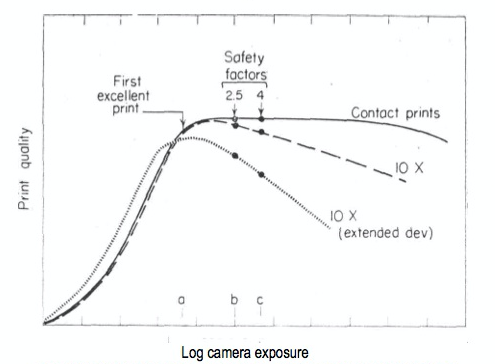

A better test of attitude was done by Jones and Nelson. They printed the negatives painstakingly to get the best image from each, then had a panel of observers rank the prints.
Those crayon box prints look like someone made them with their eyes closed.

Sadly, there is no accounting for each person's ability to make the best painstakingly made image from each so all I can provide is a reference point. That's all it is . . .

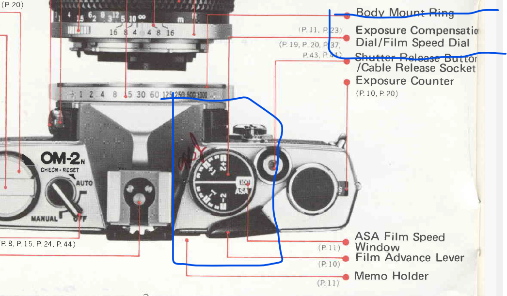

Getting back to the initial question, and to add a picture, on something like an OM-2n set to aperture priority auto, adjust the exposure compensation dial to +1 or so to add some extra exposure - see here:
