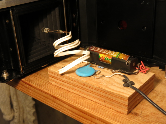

SalveSlog
SalveSlog
Sep 29, 2013
270
Southern Norway
You might want to bracket the first roll exposures. Make sure your shutter speeds are correct. Transparency film shows no mercy in exposure errors. I shoot 6x9 Fujichrome, love it!
A simple shutterspeed tester that all my cameras meet:
