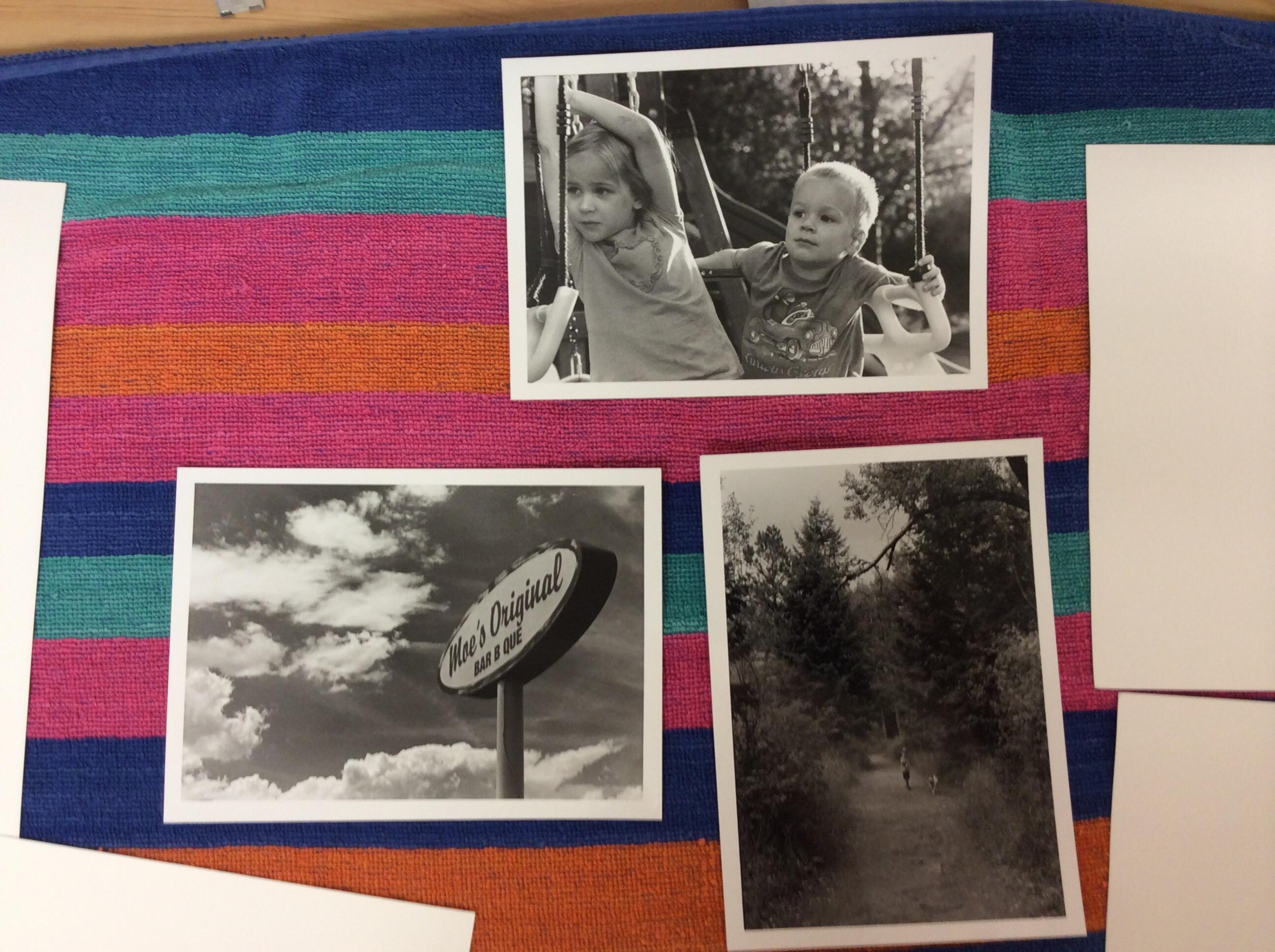

I would post a photo, but they are still soggy.
J.
RC paper dries fast. I forgot about that.
J.
Welcome back to the dark side. I'm sure you'll have the kinks sorted out in no time. Those kids are gorgeous! :smile:
You can start buring edges generously. 35mm negative is always fun to print.

Nice pictures!
I scanned those prints if you are interested.
