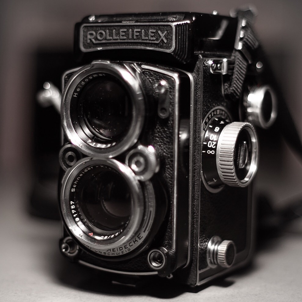

I am back in film with this beautiful 2.8C acquired locally from member "Paul in Arizona" today! Looking forward to running some frames this weekend...

I always want to have a non metered -flex. This looks beautiful.
nanthor
May 30, 2008
895
Michigan/Illinois
I've always liked the 2.8C the most, with it's 10 blade circular aperture and locking controls. Congratulations! Bob.

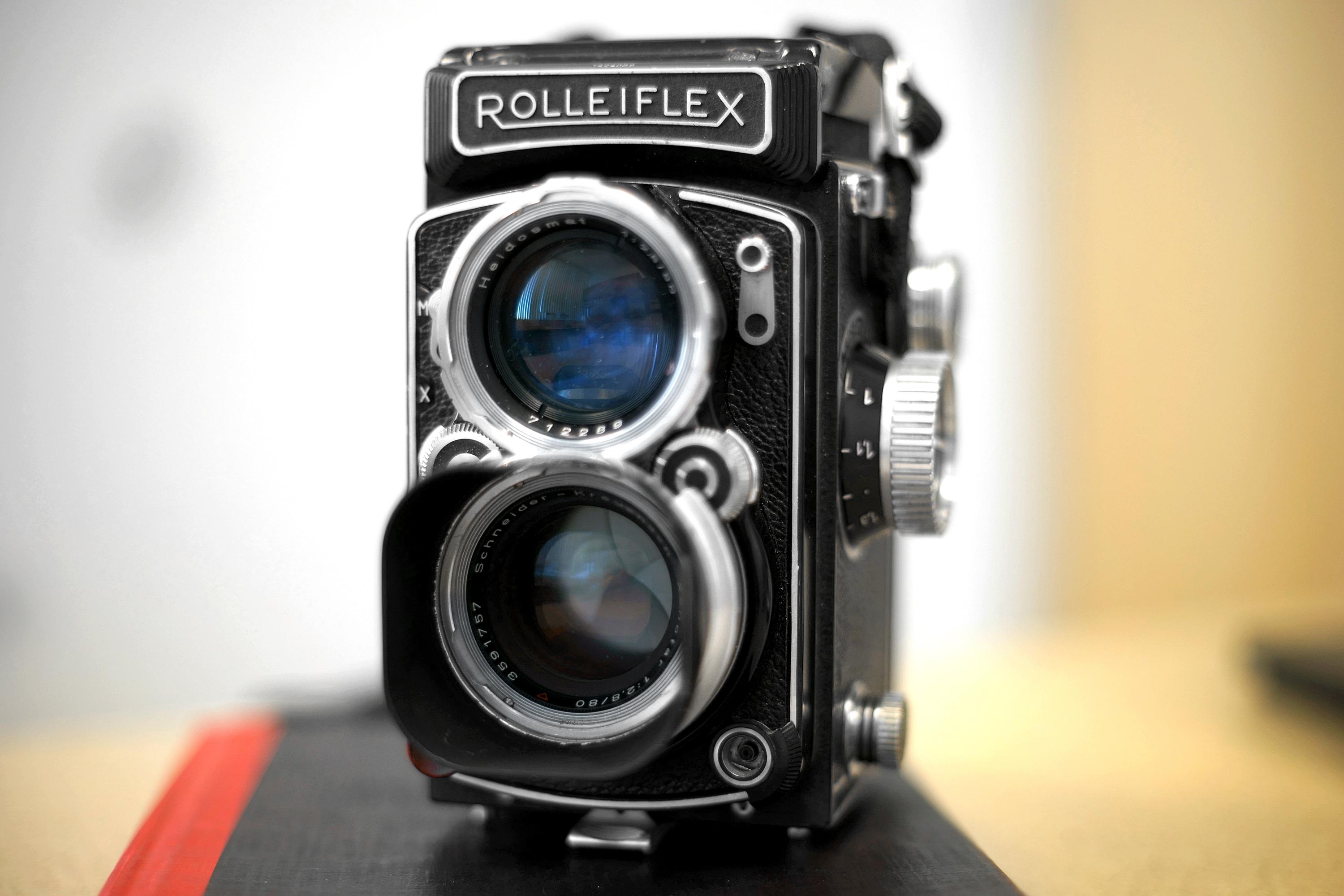

I just received a nice Bay III hood in the mail. Is there is a cap option for this hood so I don't have to keep removing/installing between uses?
