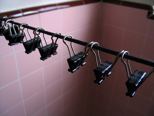

For drying i've always used small "binder clips" from Staples. You string them up and you can dry dozens of sheets about 1 inch apart in a small area. The nice feature is that the clips can be placed on the rebate area of the film w/o damaging the image area.

I'm a fan of binder clips for drying, too. I made individual little hangers for them from clothes-hanger wire, so they can be hung from a tension-hold curtain rod(s) (one, or multiples, stacked) in the bath, er, uh, I mean darkroom.
