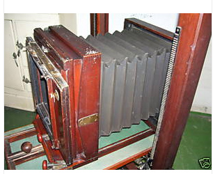

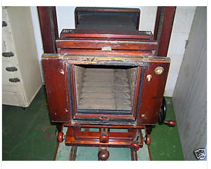

this is what the pictures showing the back looks like, the camera is a number 7.

Ok, that's an 8x10 camera and it looks like the sliding back is in place, so that's not bad. All you'd need is the 8x10 back--and you could easily adapt most wooden 8x10 backs. If the price is good and the camera is near you--buy it and start looking for a back. The 8x10 back I have on my Century 8A is likely the same fit-- 11.5" x 11.5" x 3/8" thick, with a 10 9/16" x 10 9/16" x 1/8" thick light baffle on the back. The main variation I find is that some backs have a much deeper light baffle, like 1/2". I had to use a table saw to cut the baffle depth on my back from 1/2" to 1/8". It took me an hour of work and I'm slow. You may be lucky and find an exact fit, but cutting down the baffle or the edges of a slightly large back is not difficult. You may also need to move the locking pins, but they just pull out with a pliers and you can drill new holes.

Jaime, not hard to find. Buy it if it is a bargain. It needs a normal Kodak 8X10 back like used on Kodak 2D, Century, and others. $85 - $125 is the going rate for 8X10. Less for 5X7, more for 6.5X8.5.
