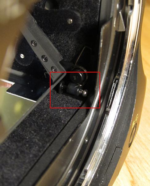

This is rather common. I had posted the picture below on another forum of the mirror stop in a 645 that is not broken.

Also, notice that the mirror stop is adjustable. That's to fix this exact problem. The constant repeated hammering of the mirror down on the stop can eventually push it downwards somewhat, and the result is inevitably back-focusing. All SLRs are vulnerable to this problem, eventually, which is why there's an adjustment.
upon further inspection, this piece is broke. Is there a good place to get one of these pieces?
