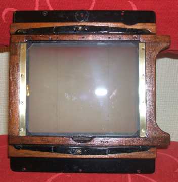

I have just started something similar. I got a 5x4 Speed Graphic yesterday. The rangefinder and focal plane shutter were beyond repair, so they have been removed, and the leather had been painted red.
I am going to remove all of the covering as you have done. It's hard to believe that they covered up that wood and brass with leather and paint!
I have the back almost done now.
Steve.

That' pre-Anniversary :D
Your problem is what to do with the speed controls cut-out. I recovered my Pacemaker Speed Graphic withe leatherette, but luckily the shutter on my pre-Anniversary Speed Graphic was restorable.
