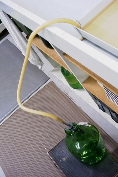

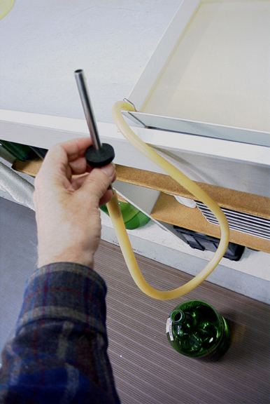

A bit of latex tubing, a length of 1/4 inch I.D. tubing, and you can siphon off every drop without spilling a drop.
No need to suck the tube completely full.
Just draw enough liquid to fill the loop hanging over the counter lip.
This is a very easy-to-clean set-up, no valves, bulbs, or other gimmicks. The latex tubing won't fight you like the vinyl stuff. It lays nice and quiet wherever you put it...
Here's how...
Reinhold
www.classicBWphoto.com

cowanw, the super siphon looks fantastic! Amazon has several similar ones listed. They are cheap enough to get one for each chemical. I think that's what I'm going to go with. Does it work well in shallow water? Even with gallon of solution, I have less than half of an inch jiggling space.

If you dont have room for jiggling, hold the hose up and fill it with a beaker of your solution, then plug the hole with your finger and drop it below the dish ; finger off and you are good to go. I use it to empty the tray my film washer sits in and it gets it down to 1/8 inch, which will be easy for you to pour or waste if there is to much particulate crap in it.
