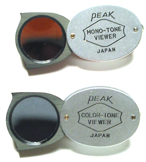

May 15, 2004
20
Peak
Hi David,
I got the two Peak viewers on ePay for about $20. I see them on there occasionally.
Jon
