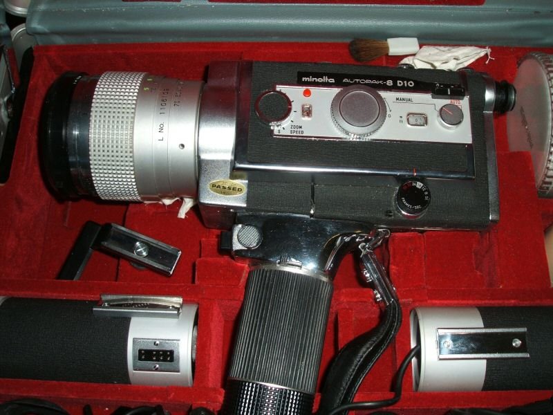

I have a Minolta Autopak-8 D10 that is the Mercedes of Minolta Super 8mm cameas with only the D12 being supposedly better. The all-black D12 has a 12 to 1 Macro Zoom Rokkor 1.8 / 6.5 - 78 mm. The two-tone D10 is silver and black and comes with a non-macro 10-1 Zoom Rokkor 1.8 / 7 - 70 mm, but the D10's lens is reputed to be sharper than the D12.
http://super8wiki.com/index.php/Minolta_Autopak-8_D_10
