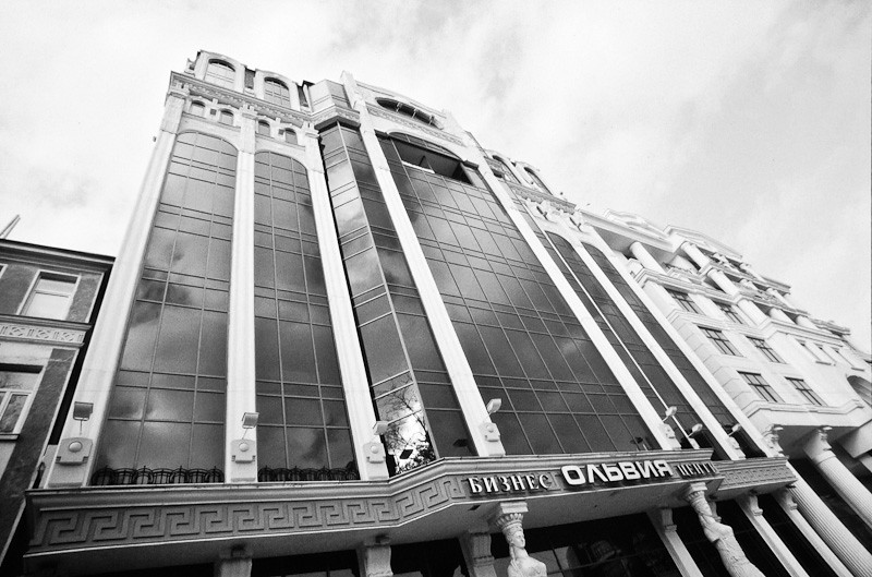

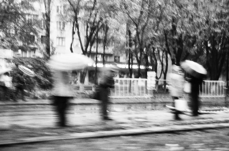

Starting dev time 8-10min 21C. Some shots from Ilford P3 200 Surviellance (expired, real ISO ~100) @200 (push+1) 14min 21C 5rotation/1min

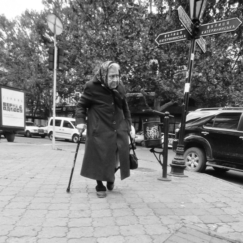

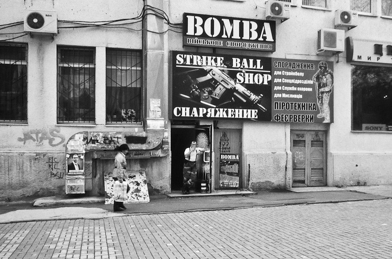

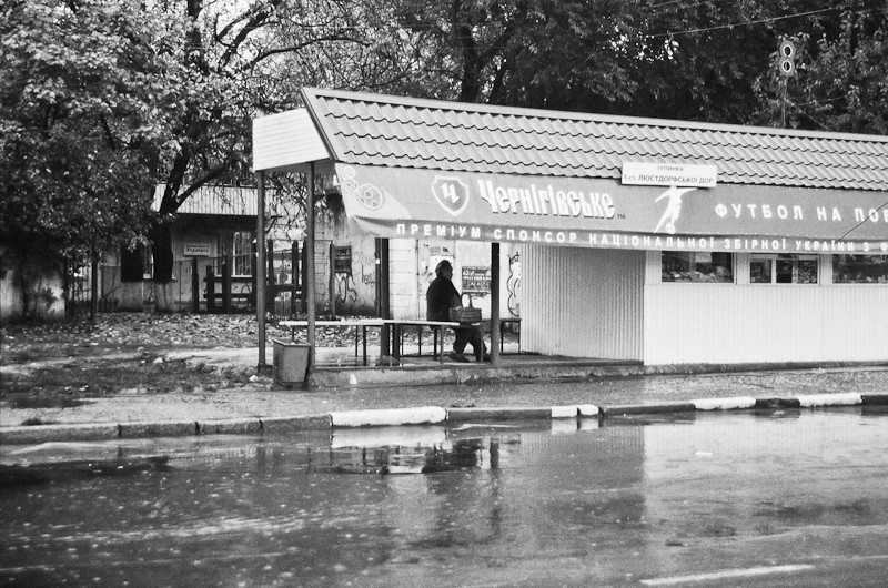

2nd attempt. same film. but @400. dev time 14min. 21C. agitation 5rotation / 30sec
