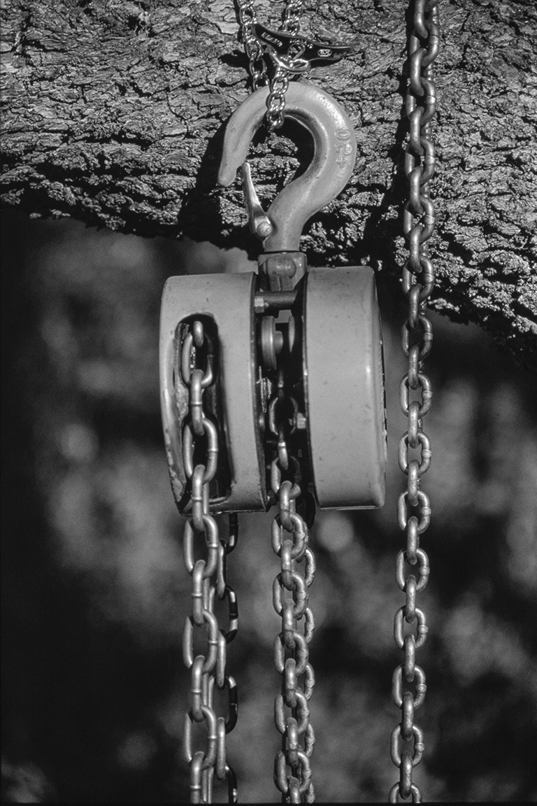

Just following up regarding the Fomapan Reversal Bath formula-Since I was unable to find anyone who had tried replicating the formula, I decided to try a test roll using the Super Iron Out. My very preliminary results show that it is as effective and even perhaps a tad superior to re-exposure to light. It is certainly faster and more convenient. Encouraged by these results and wanting to extend the top of the curve more, I have decided to experiment with the Kodak FD-70 reversal formula. Below is one of the images from my test roll of FP4 using Super Iron Out. The DMax is not what I would like, but not sure what the potential of FP4 reverse process is. DR5 claims 3.4 with compressed contrast, so perhaps that is the best that one could hope for?
FP4 135 @ISO100
1st developer D-11(1:1) + 4g/l Sodium Thiocyanate
Dichromate bleach
Potassium Disulfite Clearing Bath
Super Iron Out @ 2 tsp per 300ml of water
D72 2nd Developer (2:1)
