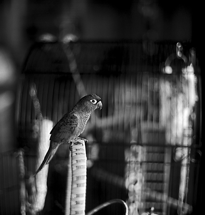

Thankyou to all who have replied. :smile: Here is a look at my first B&W Transparency see image attached. This is my bird Zoey, she is 3 months old. Image was taken with a Norita 66 , 80mm Noritar lens wide open at f2.0
Jamie
