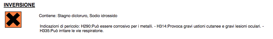

Chemical fogging agent went bad. My guess anyway. Does the packaging identify the chemical used for the fogging?
Photo Engineer
Apr 19, 2005
29,018
Rochester, NY
Stannous Chloride goes bad very fast if not kept properly. It may have been "fresh" when you bought it, but you don't know how it was treated at the factory or while being shipped. If the reversal bath was bad, I would have expected some slight ghost like image though.

Yup. My bet is the Stannous Chloride went bad. I've heard of it doing that, and it is sudden death. The old Kodak E6 kits used it for the chemical fog, and there are threads here on Photrio where that was identified as a possible problem. So, the second developer was working, but there was nothing to develop, because the silver was never fogged. Fixer then took it all away.
Try another but skip the chem fogging step and instead expose to light, and see what you get.
Edit: Tin Dichloride and Sodium Hydroxide? Are you sure? That wouldn't work, the Tin Dichloride needs to be in acid solution.

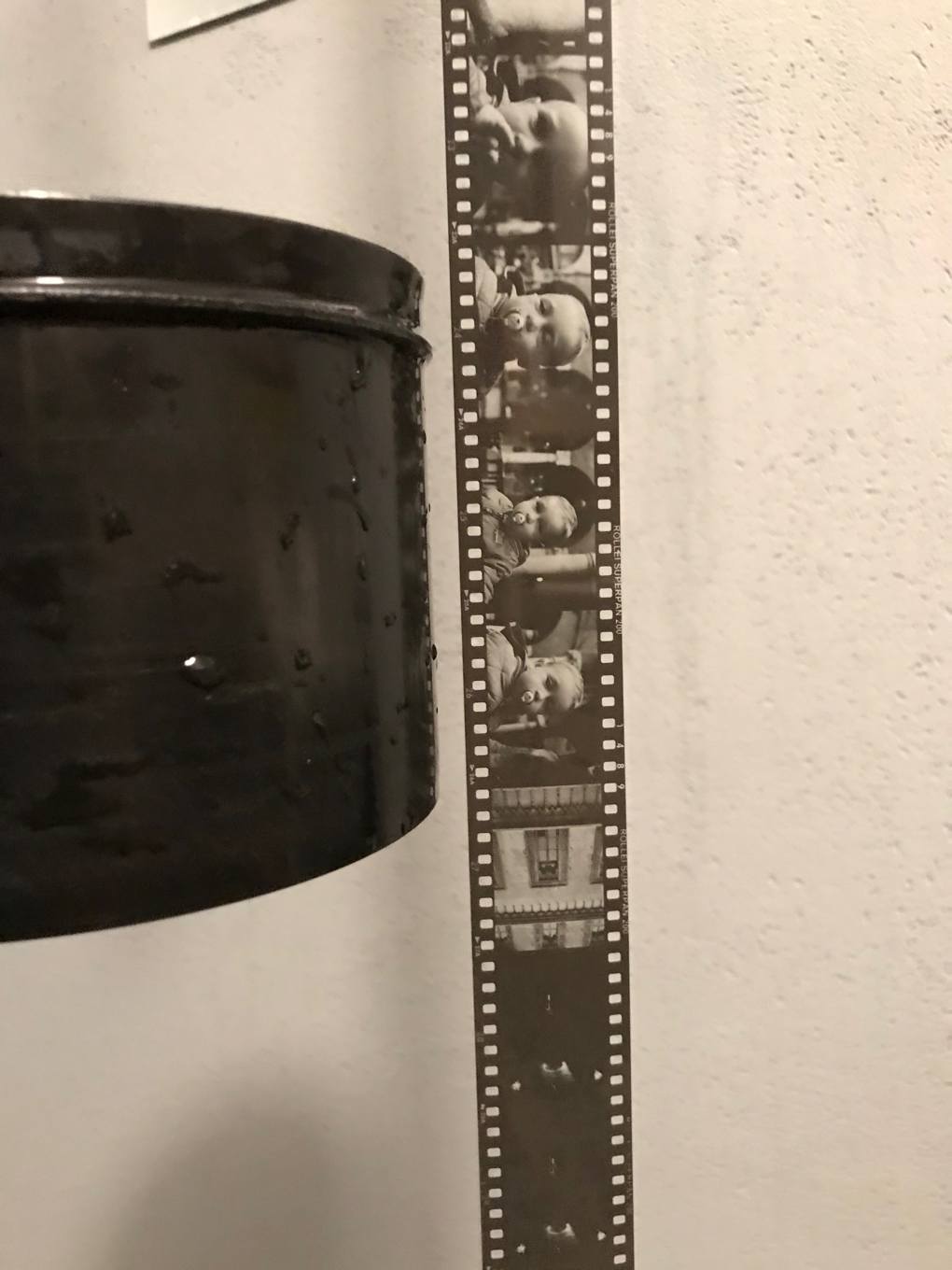

After chemical reverse, I opened the tank and checked that the film was impressed: everything ok ... the image was there and the film had its own yellowish / creamy color.

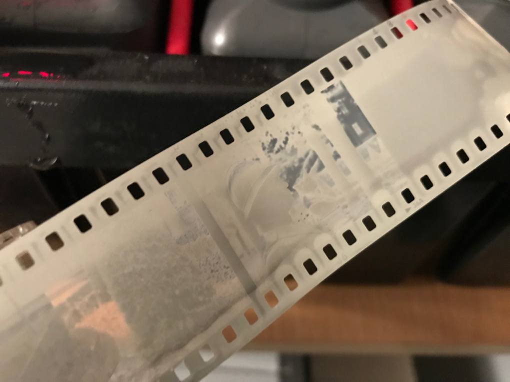

Even if the Tin Chloride went completely bad, you did look at your strip right before second developer, so the strip should have been at least somewhat exposed in those areas you looked at. Can you confirm, that your film strip is 100% blank? Can you also check, whether there is gelatin left on your film strips? Even is there is no silver left in it, it should still be detectable by its optical appearance and response to water.
gioffry
gioffry
Jul 3, 2017
25
Milano, Italy
I confirm you that my strips are 100% blank. No gelatin left. Perfectly clean and trasparent. :sad:
Rudeofus
Aug 13, 2009
5,081
EU
"No gelatin left" means more than just blank, it indicates that the gelatin layer was removed, not only the silver within. There is a non-trivial chance, that the Permanganate softened your gelatin and that the alkaline second developer then washed it away. You can test this with a simple experiment:
  1. place a short test clip into your bleach for a few minutes. You can do this in room light.
  2. take the clip out. if it is no longer milky, then the gelatin is already gone
  3. put it in reexposure bath and second developer, all in room light
  4. check test clip again: it should be completely black now

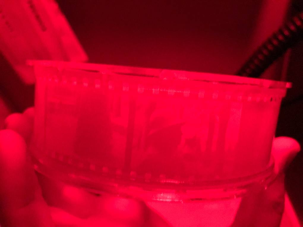

Dear friends,
thank you all for your suggestions.
Yesterday, I tried to reverse again with the same chemicals.
I did these treatments:
  • First development + Wash
  • Bleaching + Wash
  • Clarifying + Wash
  • Chemical Reverse
At this point, I opened the tank and saw this:
So I washed for 10 minutes and made the second development.
At this point, I understood everything: Chemical Reverse was exhausted (I bought it a few days ago). So the inversion process had not happened. And the second development had no effect. So I exposed the spiral to the 150w fluorescent light. I think, however, I have exposed it for too little time. In fact, after the second development and fixation, the film was not perfectly black:
But at least, I finally realized what the problem was.
