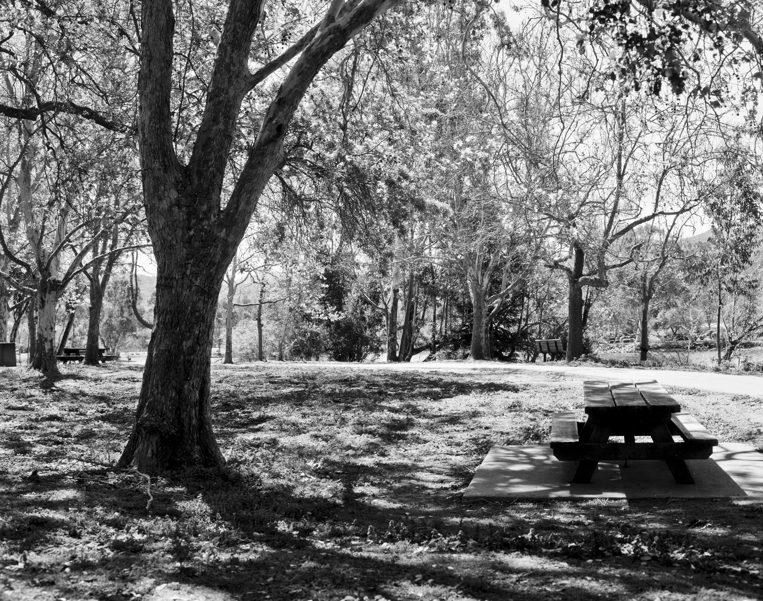

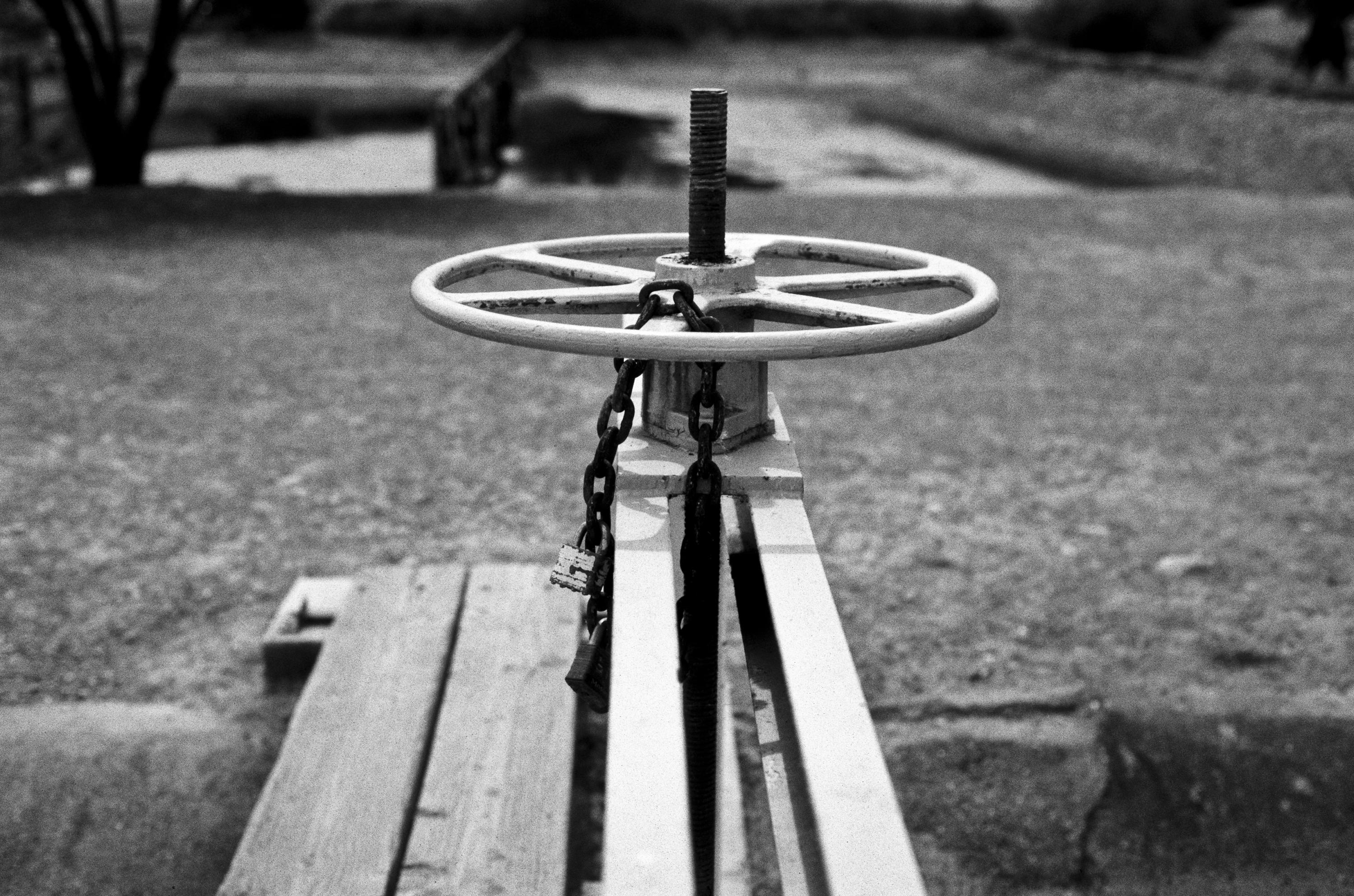

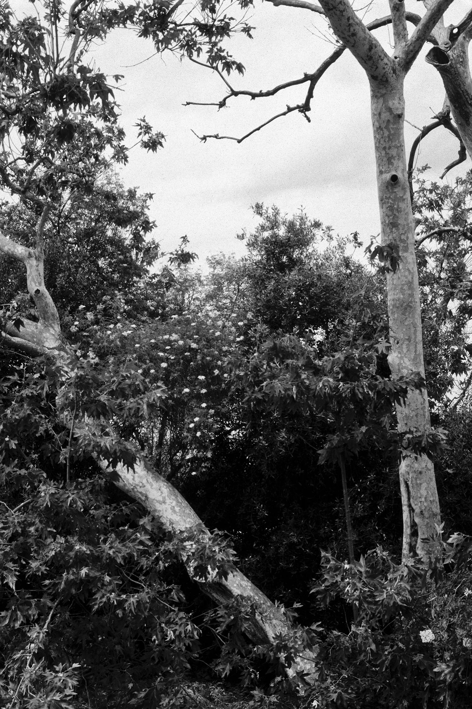

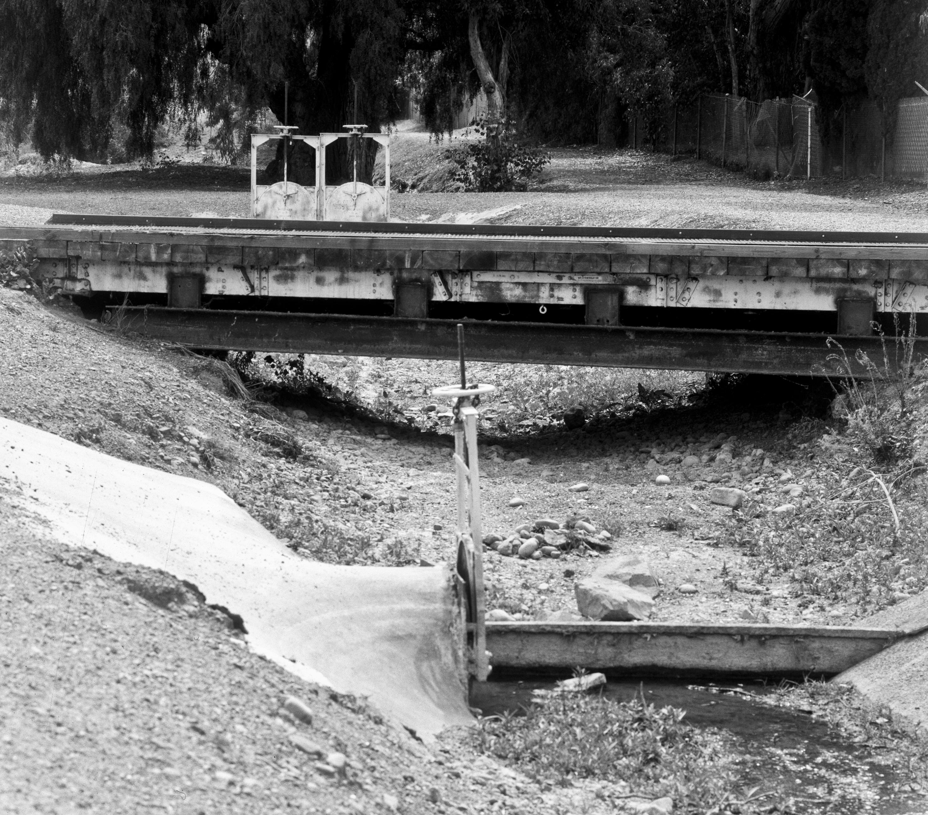

on jury duty, so took the week off (lucky me!). luckily I didn't get called into court so had the day to myself. decided to shoot a few rolls and reversal process 'em for fun. I shot a roll of FP4 35mm and two rolls of Xtreme 100, one 35mm and one 120. developed all 3 at the same time. they seem very similar to me when comparing the fp4 and the x100. If I had to guess, I would say that harmon makes the film for ultrafine. The major difference is the lack of, or a very thin A H layer on the X100. look at the pict below, at the shutter button on the pentax 67 (you can really see it if you zoom in). also, when I process the film normally (as a neg) and do a pre-soak, the water comes out clear, unlike kodak, fuji, ilford and foma. so maybe that will give you smarter detective types a better idea of who makes the film or what emulsion it could be.
scanning them (I know its taboo, but thought I would just throw this out there), I find that the both films give less grain when compared to a scanned neg of the same emulsion. Not sure why but it seems that way to my eyes.
But the joy was projecting them. both 35mm slides showed great contrast, amazing detail and was a joy to look at. The 120 slide, which was cut down just a little to fit in a Gepe 6x6 mount, was awesome! after this, I'm gonna start shooting more B&W and rev process them as I had a great time seeing them projected. here are a few examples.....
FP4
FP4
Xtreme 100 120
Xtreme 100 12
Xtreme 100 35mm

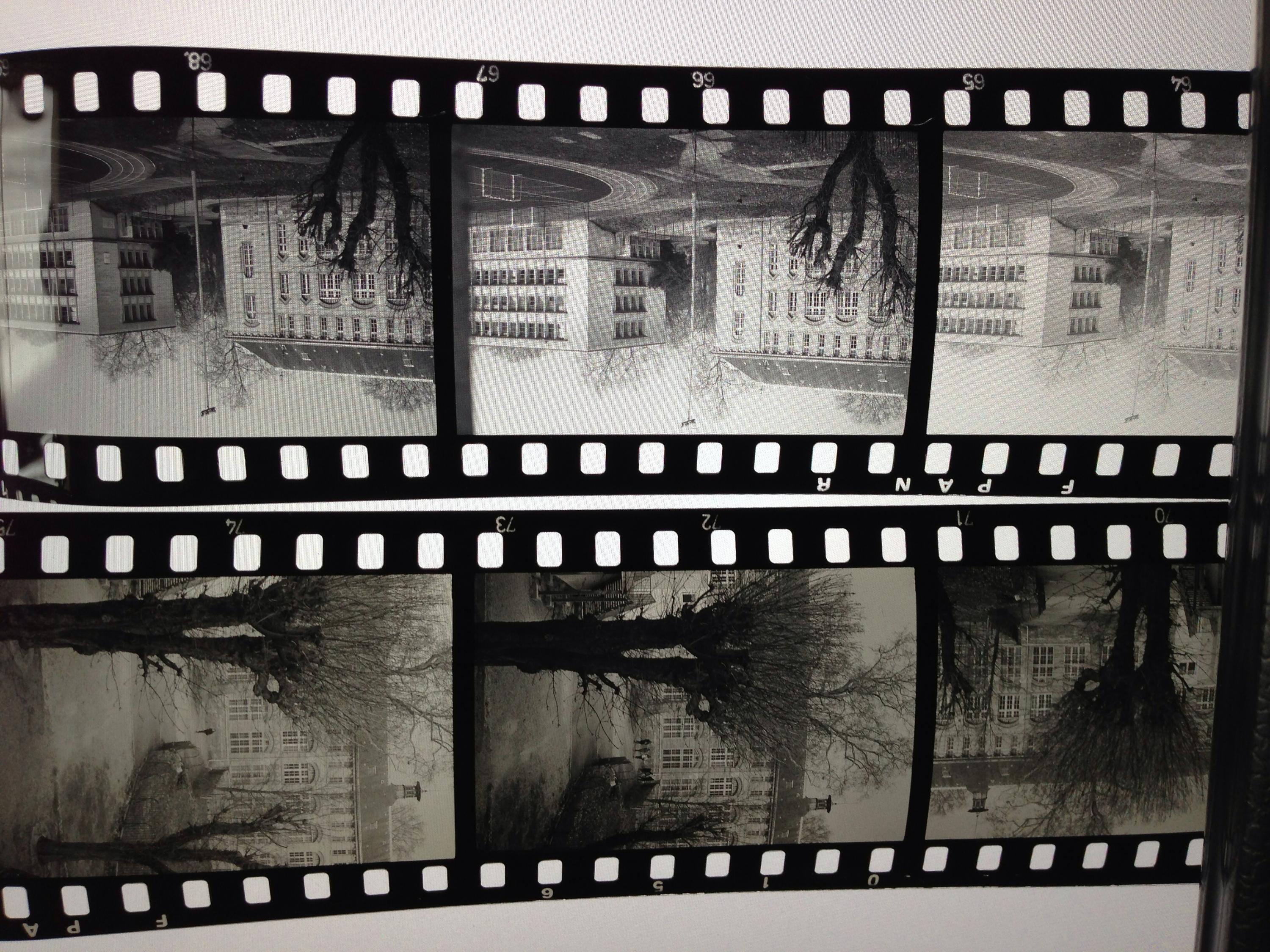

I'm using Iron Out as 2nd developer but compared with Tetenal Dokumol or any other developer it gives a sepia/olive tone to the positives. Do you get this result too ? I lose also 1 stop with Iron out, but this is correctible.
For example with Fomapan R, I get this (Iron Out on bottom, Dokumol 1+9 on top) :

yes I do get the color change, but its more pronounce depending on the film. Iron out is nice because it does so many things in 1 easy simple step
You are not actually loosing a stop per se. The iron out develops to completion and you probably were not going far enough before. Try 1st developing more.
