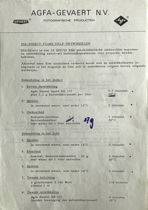

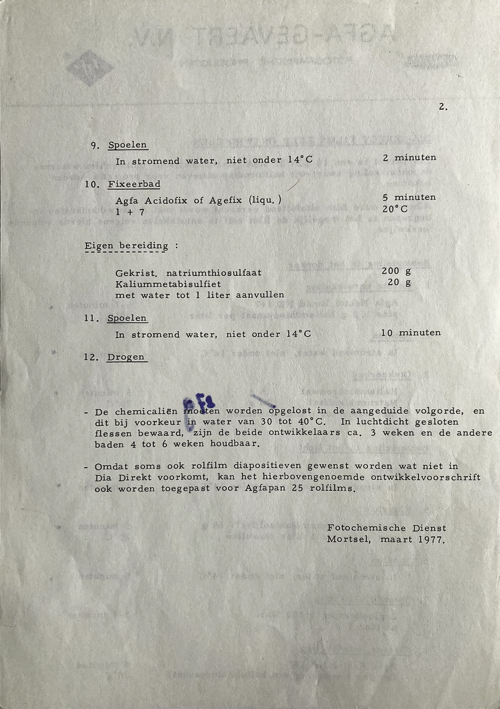

If you are talking about film reversal development, I would like to suggest the AGFA-Gevaert process, which you can see in the attachments.
Although initially intended for Dia-Direct, it works very good with Ilford's Delta 100 too (see: http://www.photoeil.be/books/dieter-roth.html)
PS: sorry for it is in Flemish/Dutch but some words and expressions are close to the Bokmål and/or Nynorsk.

It is known that tabular grain films are needing more fixer, that's why I prolonged by 1+1/2 the fixing time of the above mentioned process...

"...I keep wanting to understand better why!"
Perhaps the intensity (not only the duration) of the re-exposure?
In my Colenta, there was a cold-white TL tube buit in the cover that was very intensive.
And reed AGFA's instruction about that: two (!) 100Watt light bulbs on one meter distance for 4 minutes, that's a lot...
