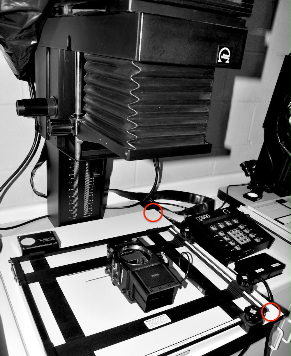

There are a few ways to go about this, but I don't have the equipment to make B&W internegatives with a camera. Yes, no bellows unit for any of my camera systems.
Printing the sides to a 4x5 sheet of film has its challenges, such as requiring a quick exposure and the requirement for test exposures ($$).
I happen to have an old Rolleiflex 6008i with fried aperture closing circuitry. Otherwise it works fine. I took the lens off and it, indeed, measures light in 'stop down' mode. Calculating the exact shutter speed required for whatever light will fall on the film plane.
So, the idea is to place the 6008i with no lens on the enlarger baseboard and focus the slide onto the reflex focus screen. Take a meter reading (or even use 'Auto') and expose the internegative that way.
Seems almost too easy and I don't have to buy any extra equipment or lenses.
I can't say I have ever used the 'bracket' exposure setting on the Rollei (I don't expose much slide film these days) but this might be an opportunity to actually use that function to ensure I get a perfectly exposed B&W internegative.

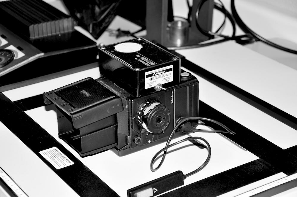

Yes the film will be in a glass carrier in the enlarger with a Componon-S enlarging lens projecting downward onto 120 film. The camera body will be used to keep the medium format film flat and light tight.
The baseboard is adjustable (red circles) to align the camera to the enlarger head.
