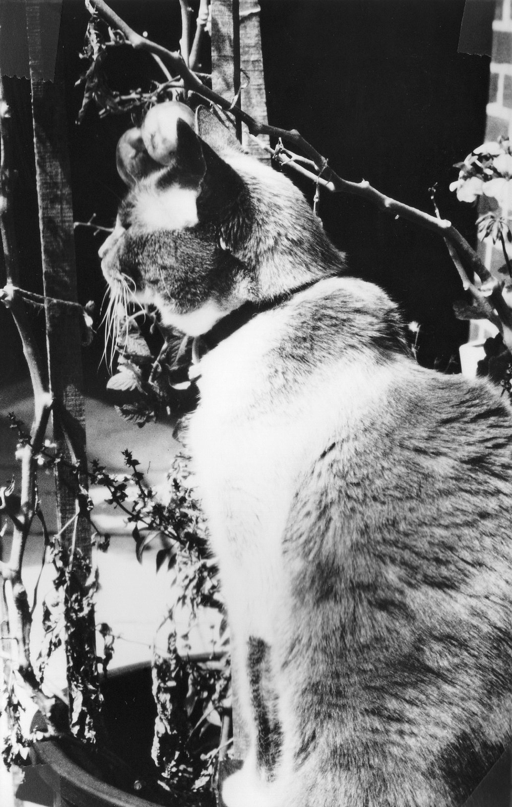

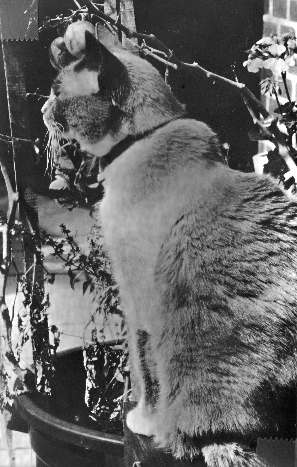

Orwo UN54 35mm reversal processed
60 sec, 0Y130M f4.5. Lacking contrast
Same frame as above
90sec, 20Y80M f4.5, Too much contrast.

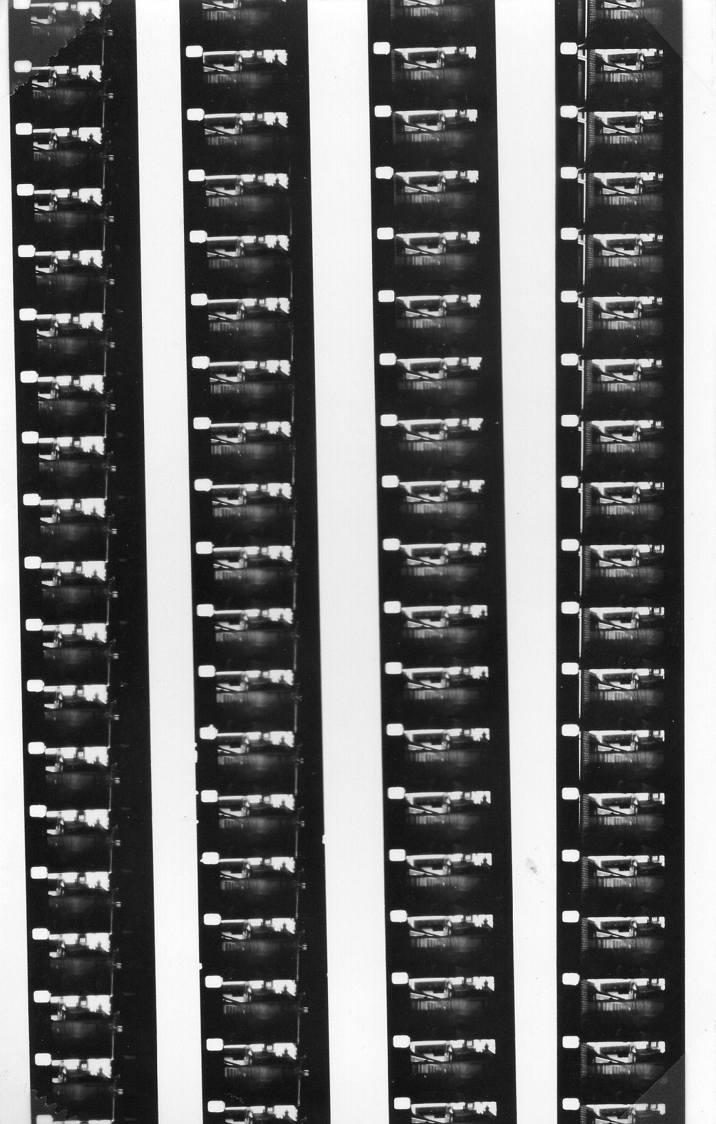

Orwo UN54 16mm reversal processed
90sec, 10Y100M f4.5. Still a little too much contrast.
a few of the 16mm frames enlarged. I did not sandwich these frames to the paper so not as sharp as they could be.
