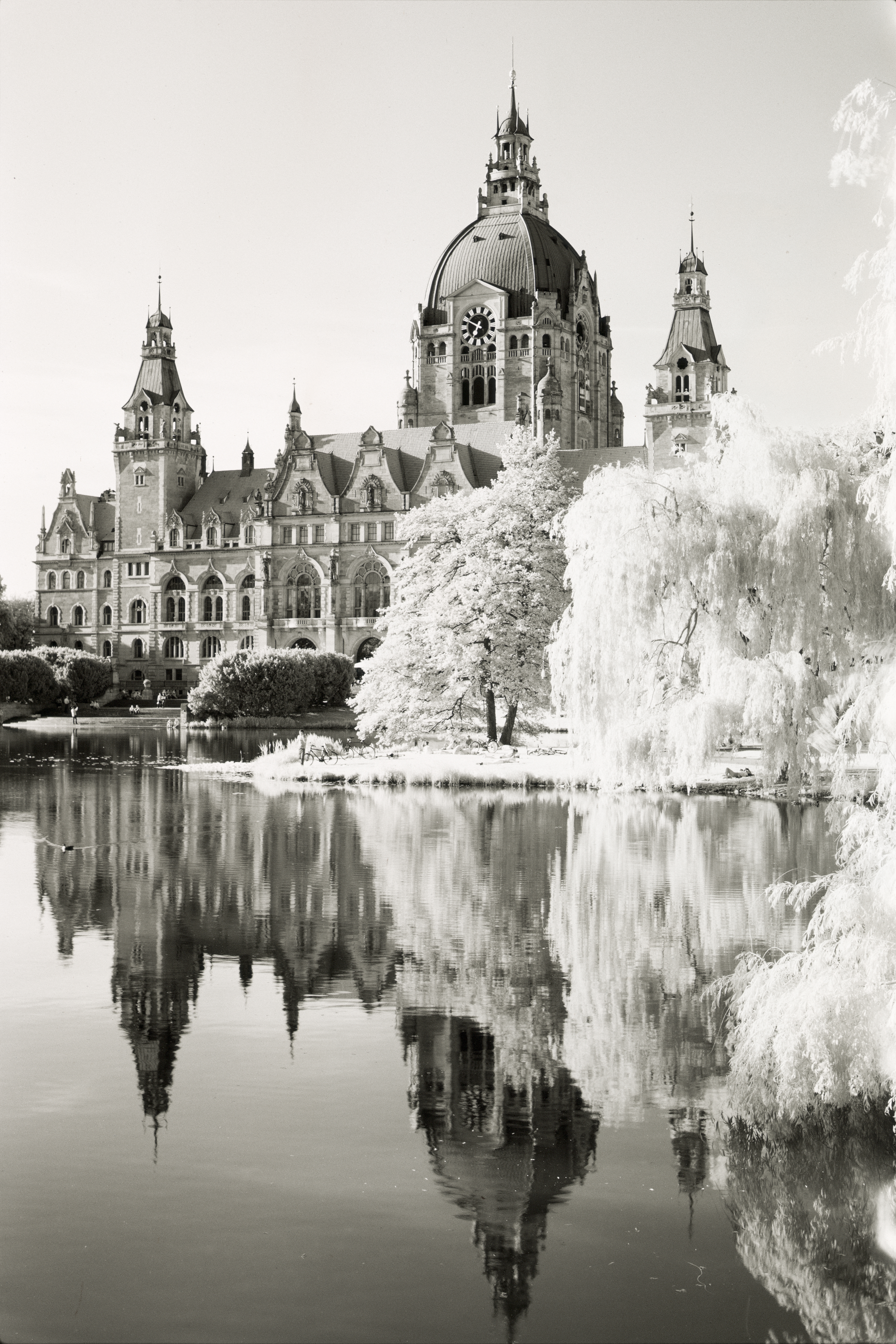

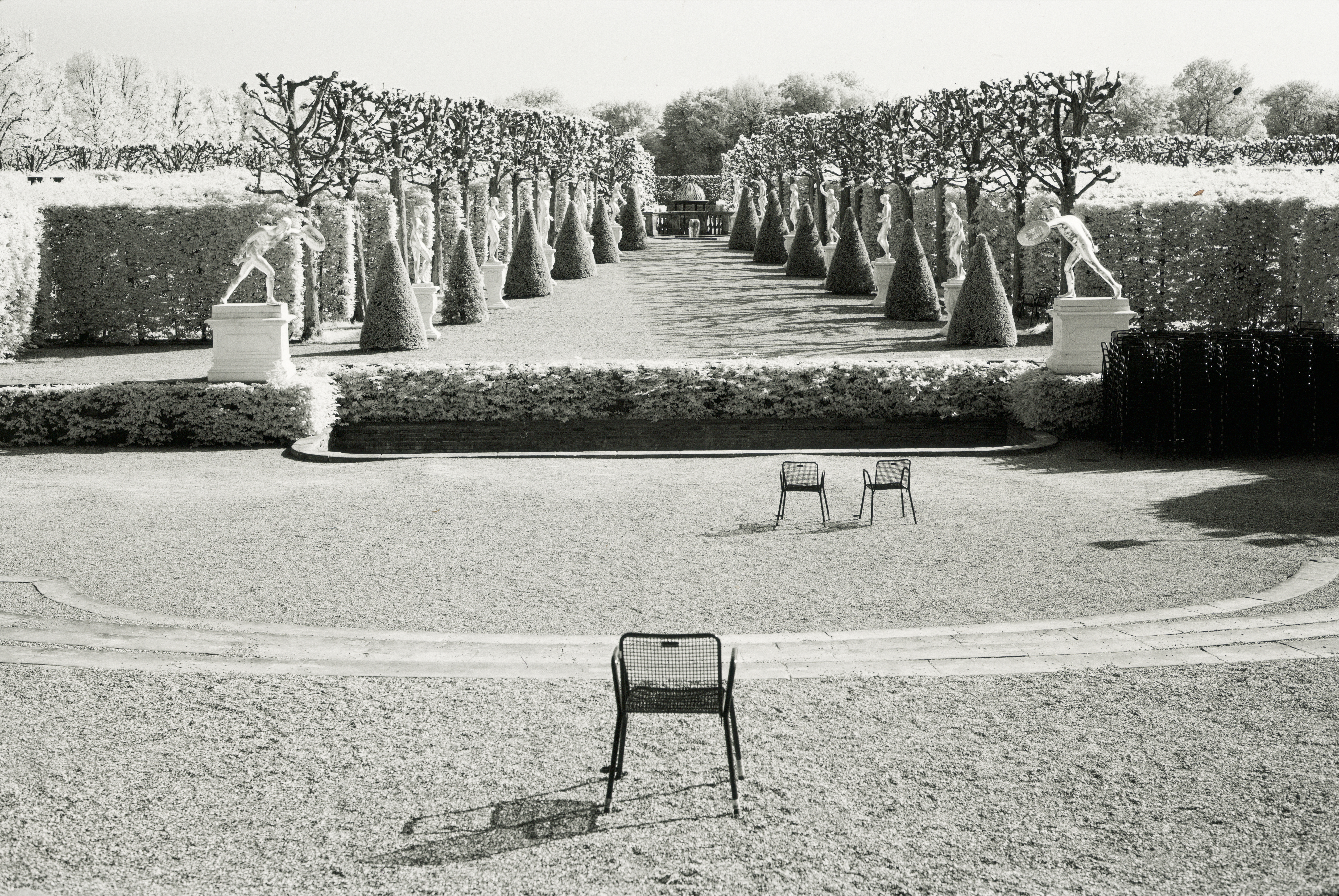

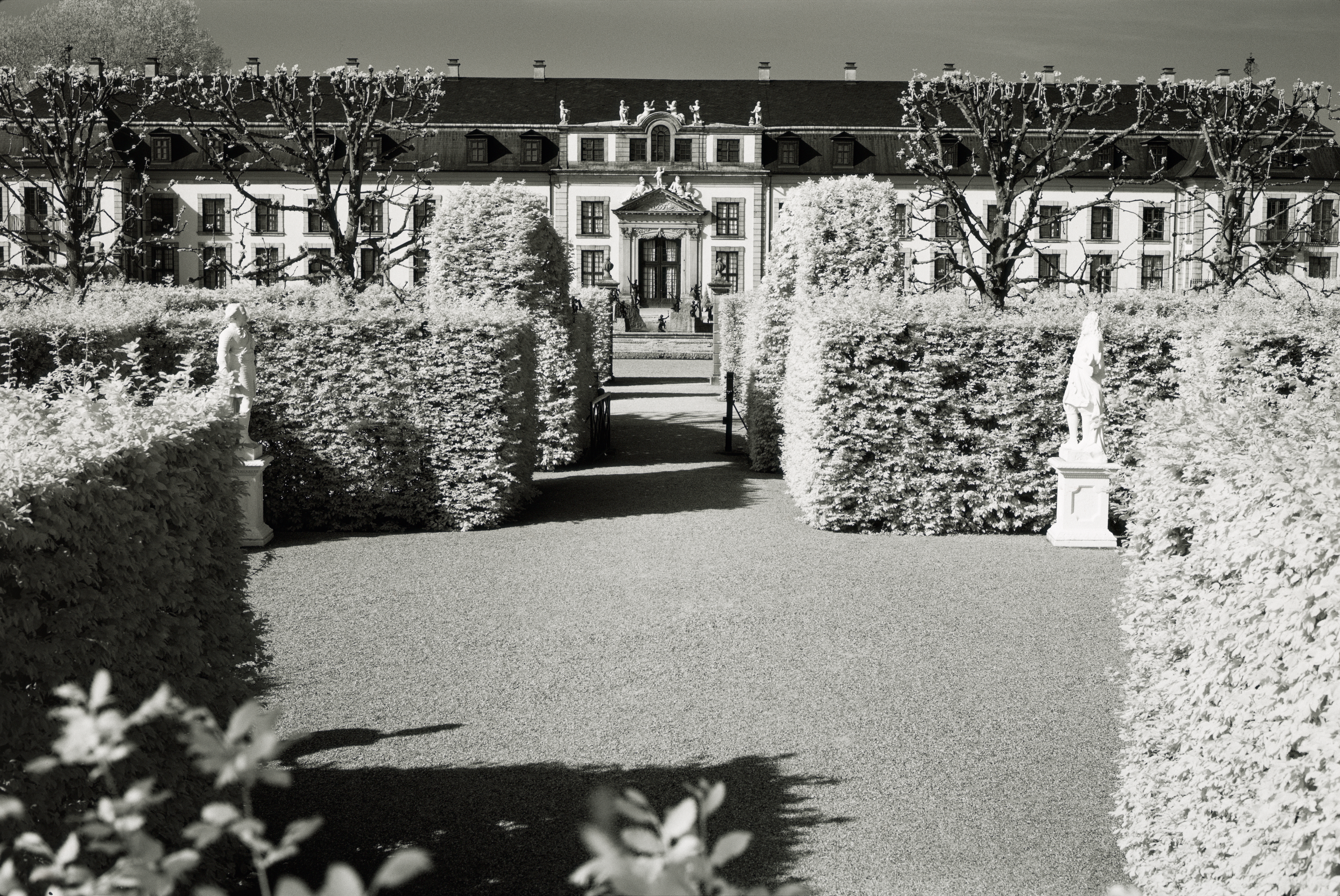

Here are some examples from me:
1. Retro 80S with Heliopan RG 715 IR filter. Developed as BW slide by Klaus Wehner ( www.schwarz-weiss-dia.de ), scan by www.high-end-scans.de:
http://www.high-end-scans.de/img/bilder/web/Serger_SWD_RR80S_03_4000ppi.jpg
http://www.high-end-scans.de/img/bilder/web/Serger_SWD_RR80S_04_4000ppi.jpg
http://www.high-end-scans.de/img/bilder/web/Serger_SWD_RR80S_05_4000ppi.jpg
2. Rollei Superpan 200 with Heliopan RG 715 IR Filter. Developed as BW slide by Photo Studio 13 ( www.photostudio13.de ), scan by www.high-end-scan.de:
http://www.high-end-scans.de/img/bilder/web/Serger_SWD_RS200_01_4000ppi.jpg
http://www.high-end-scans.de/img/bilder/web/Serger_SWD_RS200_02_4000ppi.jpg
Of course these pictures look best in projection.
