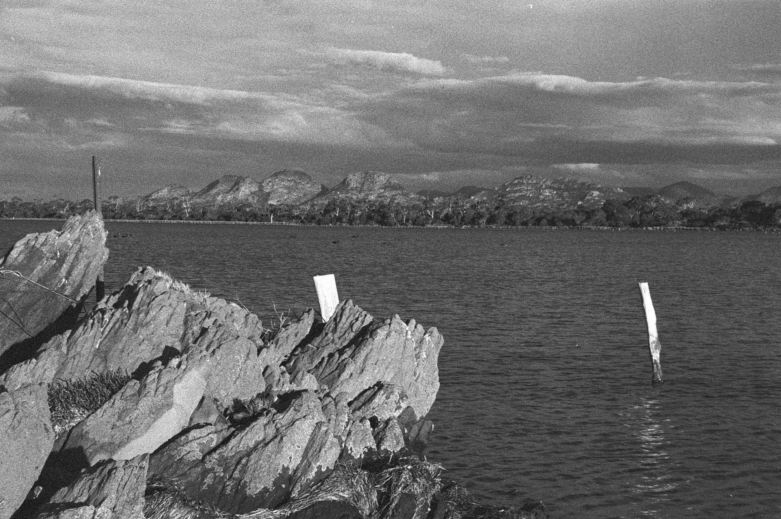

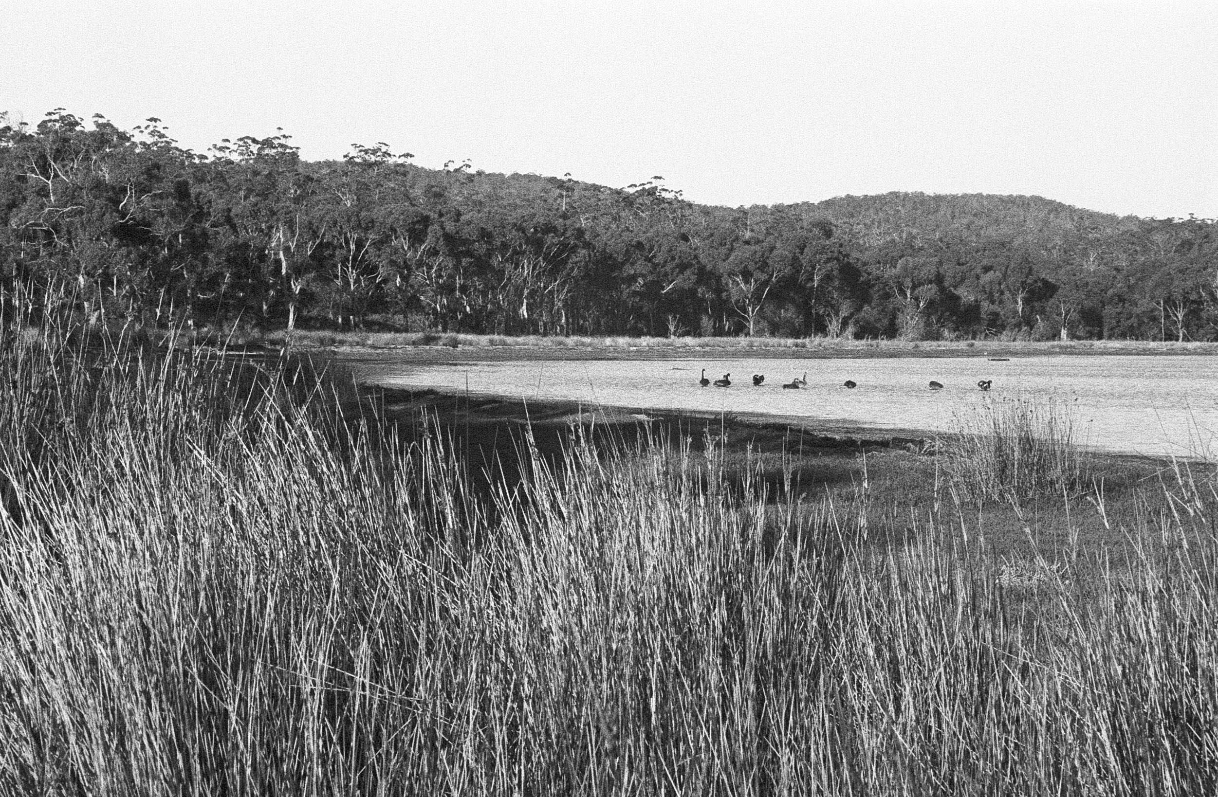

On a recent trip to Freycinet Nat Park in Tasmania, I shot quite a few scenes over ocean and lake water. Some with a Polariser filter and some without. The shots with the filter on seem to have created more grain particularly evident in the skyline. Is this a typical result using a Polariser?
Using a tripod for some lake water shots, with the Nikon FA set on P, the shots came out fine. But I tried to flatten the water with long exposures using setting A at F16 which was reading 1/8th. These just developed clear on the neg which I guess is overexposed. So is a Polariser filter not suitable for this and should I have used a red filter or a ND filter instead?
Using Nikon FA, Nikkor 35-135, Pancro 400, Caffenol C-L

Film grain is unaffected by filters.
What is affected is the light that reaches the film, so the localized contrast and the placement of tones for specific subject matter will be different.
These changes can make grain look more prominent but it is really only a difference in the exposure of the film.

Is the increased graininess apparent in the darkroom print or are you scanning the neg and reversing it for viewing and /or printing?
In other words might it be a scanning issue? Just a thought
Clear film on the B&W negative means underexposure and NOT overexposure
The negs have been scanned for viewing. I think the previous post from Mark is correct in that it is my poor exposure of the shot rather than the Polariser filter. These shots show the different results I got. The 1st photo is without the filter.
That was definitely not my point.
My point is purely that the grain is inherent in the film chosen. The fix for too much grain is not normally an adjustment to exposure, the fix is typically a different, less grainy, film choice. A 100 speed film instead of 400, T-Max 400 instead of Panchro 400, C41 instead of traditional B&W...
Jan 21, 2003
15,716
Switzerland
The second picture above is showing lots of scanner artifacts too.
I second @markbarendt and his comment above, that grain is largely inherent to the film, and while choice of film developer will affect that outcome to some extent, there isn't much one can do to get around the level of grain a certain film will produce.
With that said, underexposure will typically result in thin negatives, where the scanner will accentuate the grain because it is trying to normalize the tones that are in your negative. If you print an underexposed negative in the darkroom, you will not see that same increase in graininess.
Over-exposure will produce more grain too, but that is a result of silver density being higher in a denser negative, meaning it takes more silver to make up the image. Since there is more silver there are more silver grains, and when you scan or print such a negative the increased grain will be immediately noticeable.
So, particularly when negatives are scanned, exposure and development will be important to how much grain will be apparent in the files. When adding a polarizing filter, exposure requirements change, and the light that reaches the film surface will be different, meaning you will have to learn how to expose properly through it in varying lighting conditions for your grain to look as normal.

I don't disagree Thomas.
Part of my thought though is that typically people get very reasonable exposure values for most shots, truly poor exposures are rare in my opinion. Poor exposures are also typically quite obvious, I don't see evidence of that in the examples here.
The difference I see in these examples is that the shot with the polarizer has detail in the sky. Personally, I'd happily put up with the more prominent grain in exchange for the more interesting sky.

When scanning underexposed negatives, the software must increase the amplification digitally. The scanner lamp does not get any brighter. This also increases the apparent grain. Either from the existing grain or from dust in the optical system or digital noise.
You may find them more printable with a traditional darkroom.
+1. Underexposed negatives result in more grain apparent in the scan.
Wet printing will result in a completely different image.
The SilverFast software does not have a preset for this new B&W film Bergger Pancro 400.
This is compounding your problem. When you let the scanner decide how to scan you end up with everything averaged and you also lose information from the negative as when the scanner sets the black and white points it compresses the tonal range and effectively throws away detail. That's ok when the scanner gets it right and you don't need to adjust, but the scanner will often get things wrong.
You will get superior results if you turn off all the auto settings in the scanner and scan it 'flat'. This will result in a very dull, grey image but the file will contain far more tonal information.
You then edit it in your photoshop type software to make it look the way you'd like it to. The easiest and quickest way is to use the 'levels' tool and drag the black and white points until the image looks more or less right. You can then use the midpoint slider to adjust the mids or for finer control use the curves tool.
As you scanned it flat there is far more information in the file and this will result in smoother graduations. And less grain.
The scanner presets in silverfast are terrible.
Just as with wet printing in the darkroom, scanning requires care too.
Oh. And turn off sharpening in the scanner software. Sharpening should be the very last stage once everything else is perfect. Sharpening in the scanner will just make the grain even more apparent.

Just an FYI for those who are suggesting underexposure as a possible problem here. In this specific case the example of the offending grain is most prominent in the clouds and sky, the areas of the negative that got the most exposure, in fact obviously plenty.
If there were an underexposure problem the problem would show in the dark areas of the positive.

When you scan an underexposed neg using the auto settings, the software tries to set the black and white points at the low end of the histogram. This usually ends up with crushed dynamic range as it compresses the data, making the graduations between areas of similar tone more coarse, showing off the grain in the sky. The sharpen algorithms then make them even more apparent. There is noise in the shadows, but the grain will still be most apparent in the brighter areas.
Try shooting a foggy scene. If you underexpose it and then scan on auto, the foggy areas (brightest in the image) will be the most apparently grainy areas, much more so than the grain in the shadows.

You said if the scene were underexposed the grain would be appear in the shadows. That's what I was replying to.
The grain in a scan is almost always most apparent in areas of sky or fog or any bright areas with small changes in tones and underexposing increases the chances of getting more grain from the scan.
Scanning on auto can massively increase the grain as it inevitably reduces/compresses the tonal range. Scanning it flat allows there to be much smoother gradients in large areas of sky, etc.

No, I said an underexposure problem shows in the shadows. That isn't about grain, it's about having enough exposure to get good well defined detail on the negative in the shadow areas.
When underexposed the shadow detail is marginal on the negative. When the negative has marginal shadow data and the software or the operator tries to fix underexposed shadow detail digitally you get 'digital noise' not film grain.
Completely different problems, completely different fixes.
