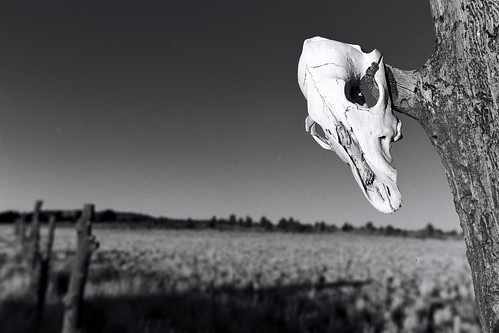

The B/W chromogenic (C-41, Ilford XP-2, Fuji Neopan 400CN) respond quite well to filtering on the camera at the time of exposure.
Neopan 400CN with Orange filter. No post processing.

Thank you Loris, pellicle, Kiron Kid and David for clarifying that the choice is either use filters with b&w film or channel mix scans from colour film.
PS Nice skull pic KK.
