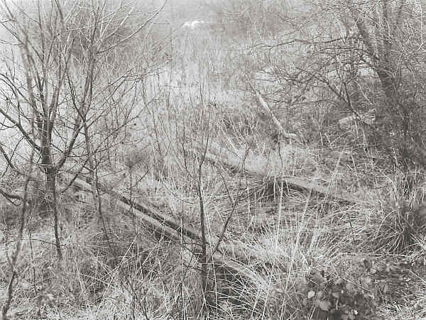

That's an interesting point.
Back in the early 90's getting up on a very foggy day my then partner poured scorn on me when I said I was off to shoot some images. She was a very (highly) competent photographer, LF & MF and a lecturer. But she was adamant I wouldn't be able to shoot landscapes that day.
I made some of my best images that day, I was hesitant whether to give increased development and decided not to, the issue was that by increasing the contrast I'd lose the subtlety and probably the whole bit about have been shooting in fog.
That days shoot produced some superb images, and 5 or 6 have been exhibited.
I think this question is also about portraying what you see and pre-visualise or a a later quite different re-interpretation in the darkroom.
Ian
