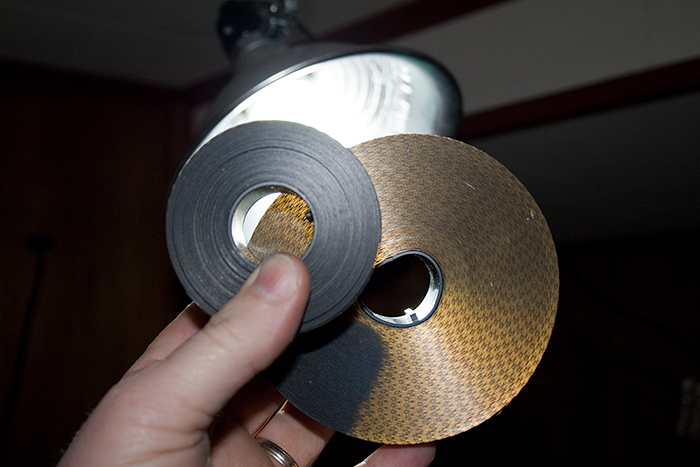

There are two basic types of film stock: Triacetate & Polyester.
Triacetate stock made by Kodak has a nominal base thickness of 142 microns. (0.0056")
Polyester stock made by Kodak has a nominal base thickness of 119 microns. (0.0046")
Polyester is a bit stiffer than acetate but the difference in thickness gives them approximately the same stiffness however, the two types of film both have a distinctive feel to them. Once you get used to handling different types of film you can often tell the difference just by feel.
Secondarily, polyester is a lot stronger than acetate. The stuff is so strong you can literally tow a car with it! If you have a jam-up inside a cine camera or a movie projector there is a good possibility of doing damage to the sprockets and the transport mechanism. Most movies are photographed with acetate based film just for this reason.
The other difference is that polyester based films are less prone to degradation. Acetate films can degrade and start releasing acetic acid vapor which causes the dyes to fade. This is one reason why old, poorly stored, Kodachrome can turn red.
I do not know of any still camera film that is made form polyester. All the film I know of is acetate but that doesn't mean that some companies aren't using it.
If you can tear the film using your fingers, the film is acetate stock, NOT polyester.

Acetate film shrinks over time, while polyester is way more stable. In the movie film business it's far more common to see polyester as a release print stock than a camera stock, for the above-mentioned reasons about camera jams and their results. But I've got a high speed (up to 10,000fps) 16mm camera that requires precision perf spacing, and I pretty much can't use acetate film in it because of the shrinkage, which occurs with time regardless of how well the film is stored. So I've concentrated on stockpiling ESTAR film for it. Runs smooth as silk... and trust me, the motors in this thing can overpower even polyester, no chance of it getting damaged if jammed!

diapositivo said:
...Another difference between the two supports is that acetate conducts light more easily, it behaves a bit like a fibre optic so to speak...
You have that exactly backwards...
The Poly film will "light pipe" Quite well...
Ploy film will stretch however. Acetate will break cleanly....
Poly also cannot be spliced with Film cement. You have to use tape or an ultrasonic splicer....
Kodak calls their Poly ESTAR.
See the attached photo: Acetate film on the left. Poly film on the right.
As a matter of fact, this is a quick way to tell film apart. Just hold a roll of it up to the light. If you can see through it, you have poly.
The stuff is so strong you can tow a car with it. I know... I did it just to prove it.
One night, after work, a bunch of us guys got the bright idea to tie some film between two pickup trucks and have a tug-of-war. Yes, the stuff stretches but it takes a heck of a lot to break it.
Duncan, I am guessing you have a Fastex camera? I have only seen one of those once. It was a film eating machine! I would imagine the sprocket holes would tear out before there was much damage to the mechanism.
When Estar film was becoming more popular in the late 1990's, one of the biggest problems was static electricity. The stuff would stick together due to static and cause film jams on the payout platter. There was lots of fun in the booth when that happened. Apparently Kodak had to put some kind of anti-static additive on the film to keep the problem at bay.
Nowadays, 95% of all movie stock is on polyester base. Aside from being more stable, one of the big reasons they say it is used is because it is easier to recycle.
