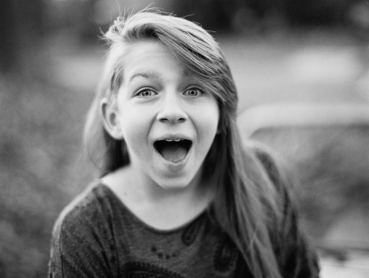

Heres a 645 TMY neg that shows the grain structure a bit. Flat light this day was overcast
D76 1+1

brucemuir,
Nice example!

Oh yea it's pretty smooth.
That's 645 also so if you get 6x7 you'll do better yet.
It's not unseeable like TMX can be but it's pretty dang clean.
