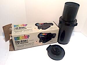

I've been using a Jobo 2551 drum and reels on a Unicolor Uniroller since the early 1980's. I arrived at this combo after testing SS, Patterson and Unicolor drums and reels for E-6 processing in all formats from 35mm to 4x5, but especially for E-6 slide duplication film, which was the most persnickety and difficult film to develop consistently and evenly. Jobo tanks and reels were the only equipment that didn't result in streaks and uneven development, presumably because they filled from the bottom up instead of splashing developer on the film from the top down. For most of my projects, to be safe, I shot two identical batches of film and sent one batch to a local pro specialist film lab for processing and developed the second film batch myself with my Jobo/Uniroller equipment. Every single time my Jobo/Uniroller batch came out more consistent, streak-free, and color-accurate than the pro lab. My only complaint was that it wasn't possible to dry the film on the plastic Jobo reels without getting drying marks so I had to re-spool the film onto SS reels before the final stabilizer step and dry the film on those reels.

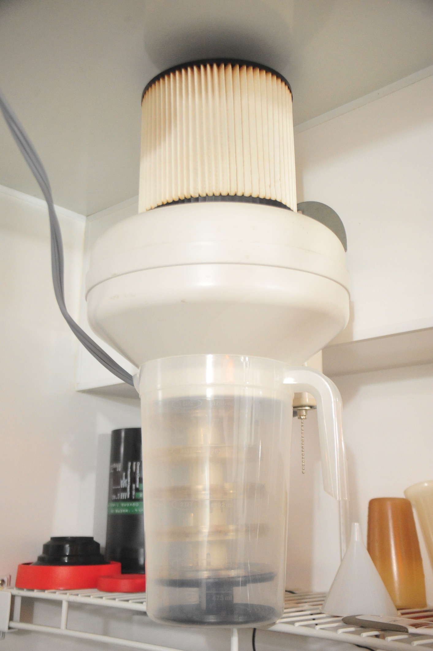

I built my current darkroom about 5 years ago and tried an experiment. I took an inline blower fan left over from an HVAC project, added a Shop-Vac filter to the intake side and cut the bottom off a cheap plastic pitcher to hold the plastic Jobo reels, and the blower just blasts the last drops of Photo-Flo off the film and dries it without leaving any drying marks. And it works just as well for 35mm, 120 and 4x5.
