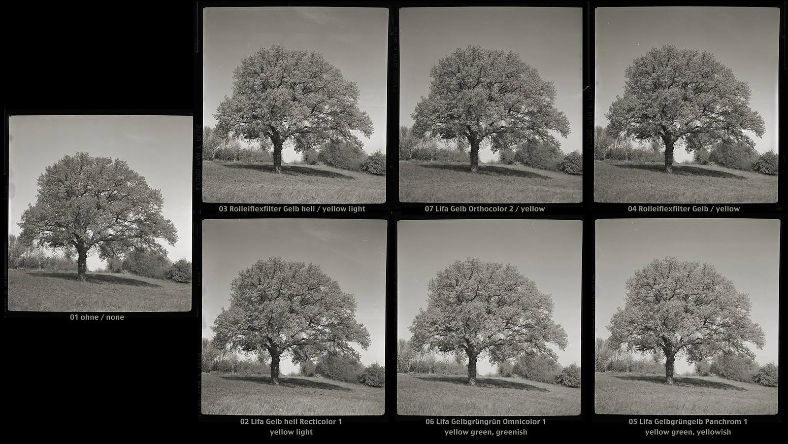

Dear Matt,
great advise! Should have done that much earlier instead of ruining my greens often with a #22 filter in the late 1980s...
A side by side comparison like i did here is good to learn what you like and want.
or more subtle:
Film here: Ilford PanF Plus 120
Best
Jens
