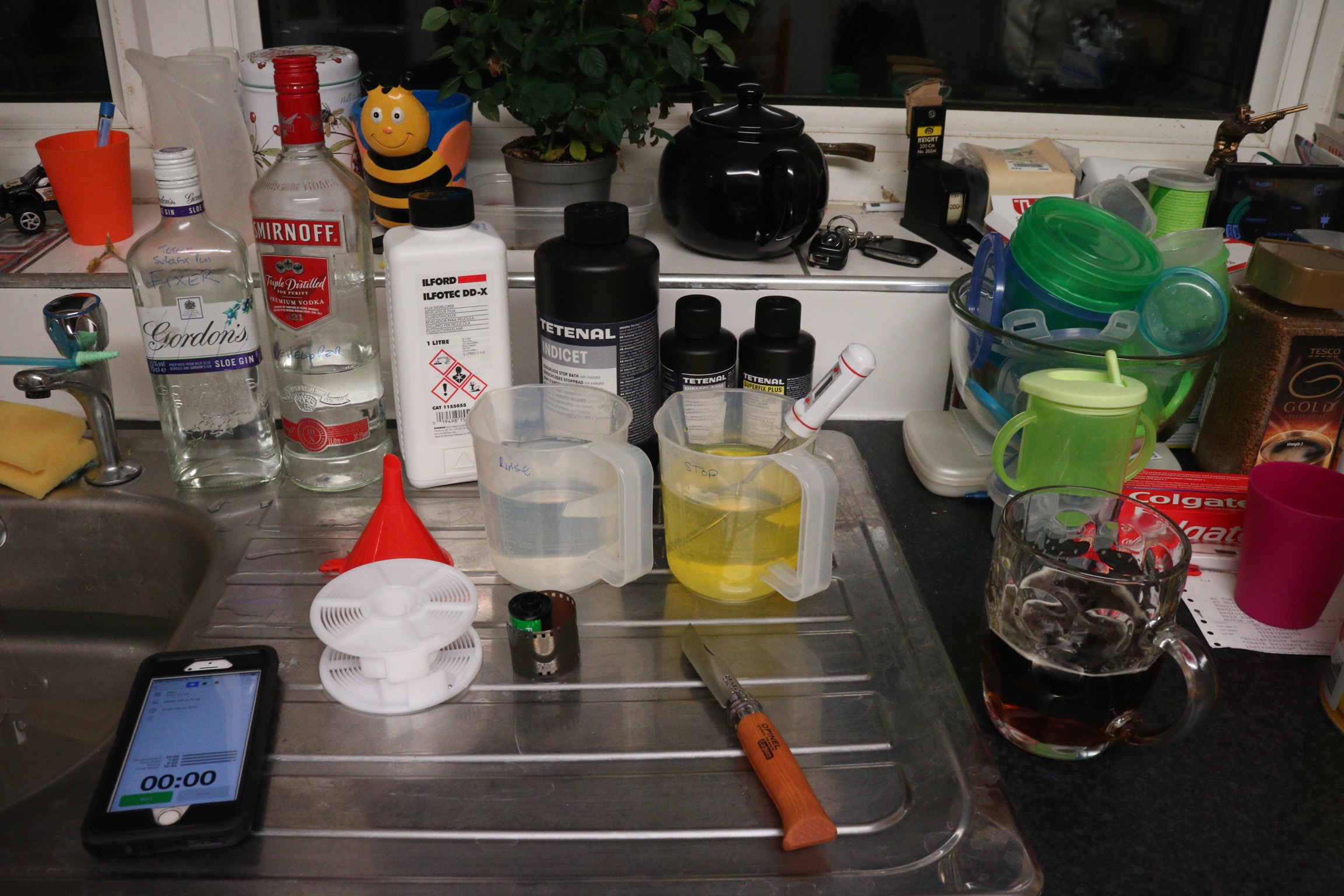

Thanks everyone! The chart is very useful too. Has anyone any tips of maintaining chemical temperature? I'm planning on using a roasting tray (she doesn't know yet) with water and then some old gin bottles to keep the mixed chemicals in. Not ideal I know but it will hopefully do for now!

Only the developer really has to be at an accurate temperature. Stop and fix don't matter so much but developer temp and time govern development. I have a 5 litre water container that I fill and adjust to 20 degrees using an aquarium thermometer. Use this to mix up the developer and tip it in to the tank. Unless your neat developer is at a vastly different temp then it won't affect it much. Maybe if developer was really cold I would really check temp before putting in tank and make a time adjustment particularly with ddx which is 1:4
Once in the tank just agitate as directed empty add stop , empty add fix, empty rinse as directed. Don't forget stop and fix can be reused. You can reuse developer but most people use it one shot.
Temp is important as is time and developer strength, but they aren't critical to the extent you won't get a result. Just keep consistent and as accurate as you can for best results.

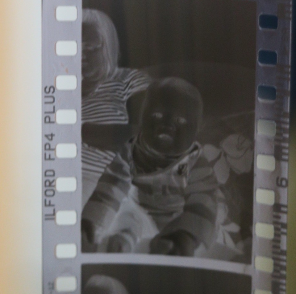

Thank you all for your help. Despite a very successful practice run loading the spiral i did struggle to load the live negative, however I believe I have had success!! Many thanks.

Molli
Dec 28, 2009
1,023
Victoria, Australia
Congratulations! Even years later, I still have a feeling of relief when I pull the negatives off the reel and, lo and behold, there are images on it :smile:
Pro Tip : Don't use her roasting tray!
My darkroom ranges in temp from cool (I need to warm my developer) to hot (I need to cool me and my developer)
For film development I have found that tempering (adding cold and hot to get to the desired temp) a std bucket of water gives me enough to mix my developer, rinse the developer out (I don't use a stop bath), rinse the fixer after that step and either fill the tank ready for the hose from the tap to be run, or perform an Ilford wash (several rinses/changes of water as described somewhere on their website). As the bucket is about 9L (I think) it holds it temp well for the duration of the film developing process.
Some things I do to add to this process. I ensure my developer is the temp I want. This can mean adding cold water from the fridge or hot water from the tank. I say 'I want' because if it's real hot I'll make it 1 or 2 degrees cooler so that once poured into a warm tank, the final temp is about what I want. No science to this, I just measure the temp with one agitation left and decide if I pour the developer out then (temp is a bit over) or agitate and leave it for the full time. Since my rinses are all going to be within a degree of the developer, I usually make sure the fix is also withing a few degrees. Generally it will be but during summer it will be hot, so I cool it down buy standing the bottle in some cold water.
If the water coming out of the tap is really cold, say 12-14C, I'll do a Ilford rinse. If it's a bit warmer then I'll most likely run water through the tank. If it's hotish (gets up to about 26-28C in summer, I'll probably still just run it through the tank, but in all cases I start with the water in my tempered bucket, so that as the water changes in the tank, the temp changes slowly.
