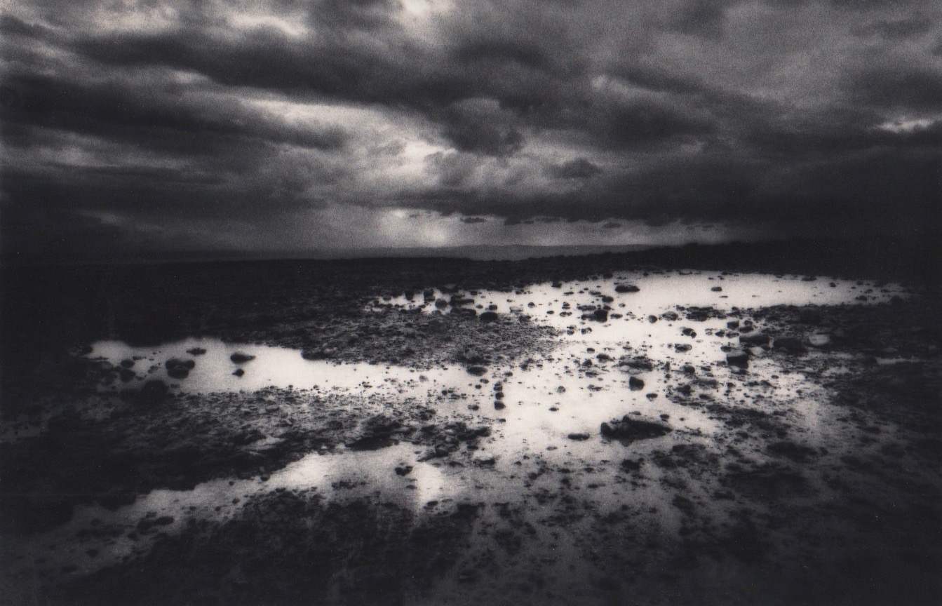

An example of a recent print with below enlarger lens diffusion. Using an old Multigrade below lens filter holder, I removed the gel from one of the filters and replaced it with a square of black stocking. The neg is 35mm FP4 processed in D76, and printed onto Ilford FB Classic at grade 5. The neg was a little over exposed, and the diffusion helped to break up the harshness of the grain.

An example of a recent print with below enlarger lens diffusion. Using an old Multigrade below lens filter holder, I removed the gel from one of the filters and replaced it with a square of black stocking. The neg is 35mm FP4 processed in D76, and printed onto Ilford FB Classic at grade 5. The neg was a little over exposed, and the diffusion helped to break up the harshness of the grain. View attachment 206346
That is a great image. My Beseler 23c has a funky little below the lens filter holder with a red filter that has probably been there forever. It might be interesting to wrap a black stocking around a thin clear piece of plastic sized to that holder. Also read that Vaseline coated glass has a similar effect. Wouldn't it be fun to buy Vaseline and womens stockings at the same time?
