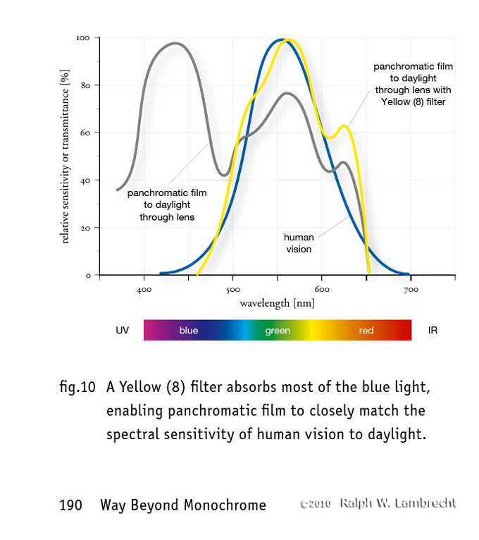

You are absolutely correct and have noticed what many photographers have noticed before. Within limits, your observations can be verified by photographic science (see attached).

I am "seeing" the graph... would you translate that to me as to what I should be reading from the graph??
Oooops. I was looking at the graph itself and didn't read the caption. sorry about that.....
True with TMAX films (http://www.kodak.com/global/en/professional/support/techPubs/f4016/f4016.pdf page 14, spectral sensitivity curves), but not with all films. For example, HP5+: http://www.ilfordphoto.com/Webfiles/20106281054152313.pdf (page 1), Delta 100: http://www.ilfordphoto.com/Webfiles/201062894918374.pdf (page 1). They have considerably lower blue response than green-yellow-red.
Furthermore, there are different kind of yellow filters, regarding the cut-off wavelength and stop-band density. If you use a really yellow filter that filters out all of the blue, the result is very far from "what we humans see".
So, yellow (or better: yellowish) filter converts a TMAX film to more like Ilfordish in the terms of color rendition.
Thanks for the graph, Ralph. Good information.

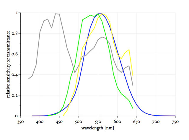

I'd like to see a similar graph with a Wratten #11 filter. I've always liked it as a "general-purpose" landscape pix filter. Seems to act like a light yellow filter, but seems to alter greens a tiny bit more.
I generally tend to like how unfiltered b/w panchromatic film renders things a bit differently than what our eyes see, so filters are the exception for me. I sometimes like ortho films for landscapes too. To each his/her own.
To the OP, I'd always use a yellow filter if you always want to achieve what Mr. Lambrecht's graph shows.
True with TMAX films (http://www.kodak.com/global/en/professional/support/techPubs/f4016/f4016.pdf page 14, spectral sensitivity curves), but not with all films. For example, HP5+: http://www.ilfordphoto.com/Webfiles/20106281054152313.pdf (page 1), Delta 100: http://www.ilfordphoto.com/Webfiles/201062894918374.pdf (page 1). They have considerably lower blue response than green-yellow-red...
Not really, the charts aren't comparable. You see, Kodak's spectral sensitivity curves are made with exposure to daylight balanced light, whereas Ilford's are made with tungsten (2850°K) light. AFAIK, in order to make these charts, light passes through a prism and then exposes a piece of film. Different parts of the film are exposed by different wavelengths and they'll have different densities after development. Then the densities are read and you get the relative spectral sensitivity of the film at different wavelengths. Daylight has relatively uniform spectral power distribution throughout the spectrum, while tungsten light on the other hand is very different and has a lot of power in the longer wavelengths (towards red - IR). So, if the light you use delivers far more energy at the red end of the spectrum, it will definitely give a spectral sensitivity curve with a peak at the red end of the chart, while daylight would result in a curve with a peak at the violet - blue end.

... I'd like to see a similar graph with a Wratten #11 filter. I've always liked it as a "general-purpose" landscape pix filter. Seems to act like a light yellow filter, but seems to alter greens a tiny bit more. ...
I have the data to prepare that graph. Just need to exchange the filter data. I'll get back to you.
Interesting, Ralph. The #11 more closely and smoothly matches the shape of human vision in the graph. I never knew! Thanks again. More good information. (How do you do that, anyhow? :D)
