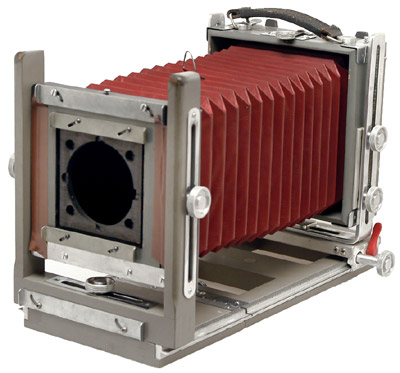

What lensboards do a B & J 4x5 View camera take?

I'm watching that one too....good luck.
It looks like this one is fitted with some sort of adapter board...perhaps to allow one to use a standard size - maybe Toyo field or Graphic?

According to my 1959 B&J Catalog it should take a 5 1/4" lens board. That adapter may be for the 3 5/8 metal speed graphic type boards or it may be 4X4. There's definitely an adapter there though.

I don't know about that one, but my B&J monorail (Orbit) and my B&J press both take 4" boards. Some of the wood ones are even stamped "Burke and James".

That is not an adapter on that B&J, it is the end of the bellows. They are folded inward and seat around the lens I guess to improve the light trap. I have one just like it except stripped of that horrid paint sitting here with me. Someone cut that junk out of mine. They look good in stain and lacquer.
