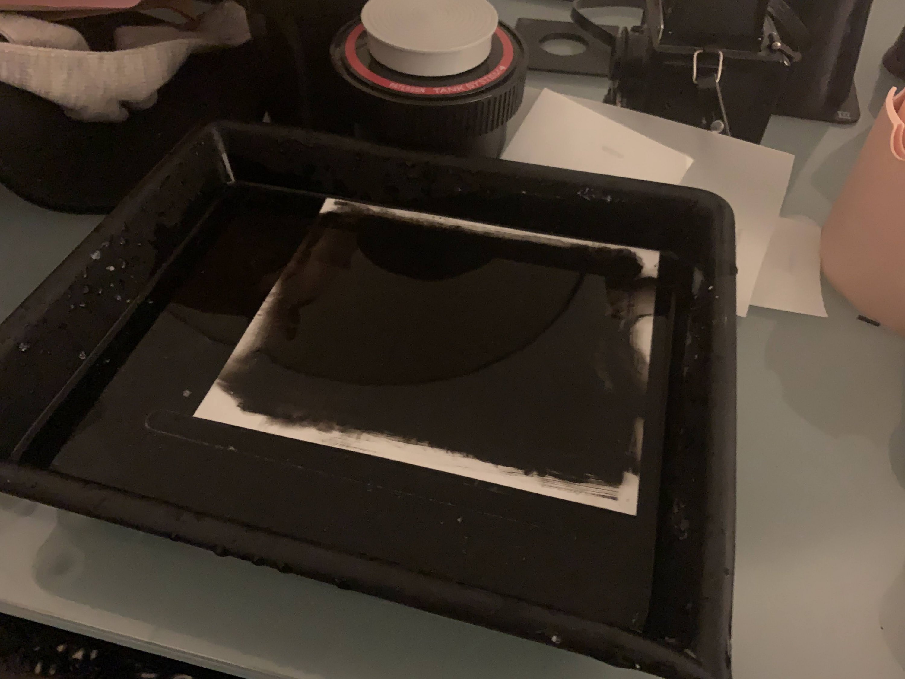

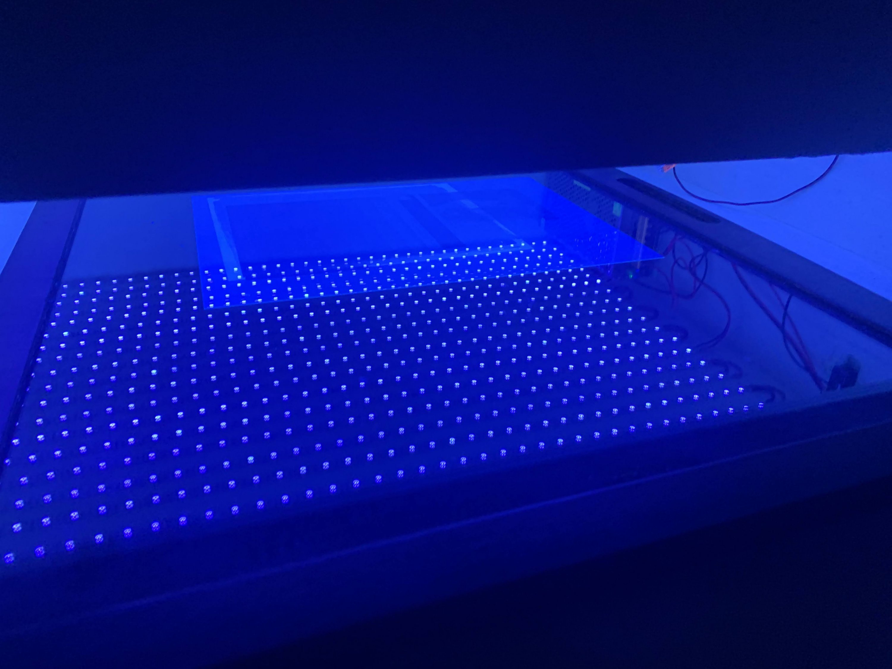

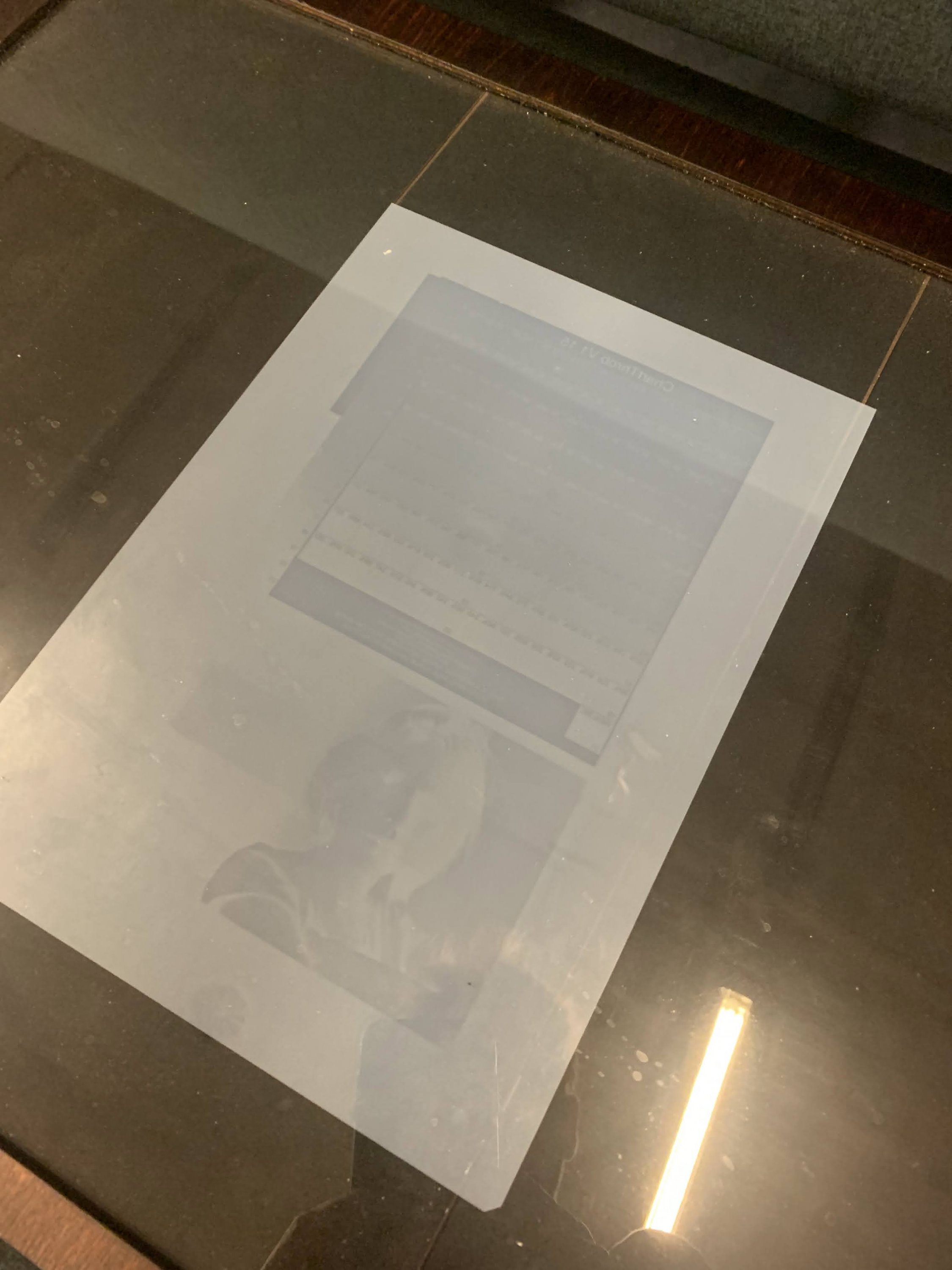

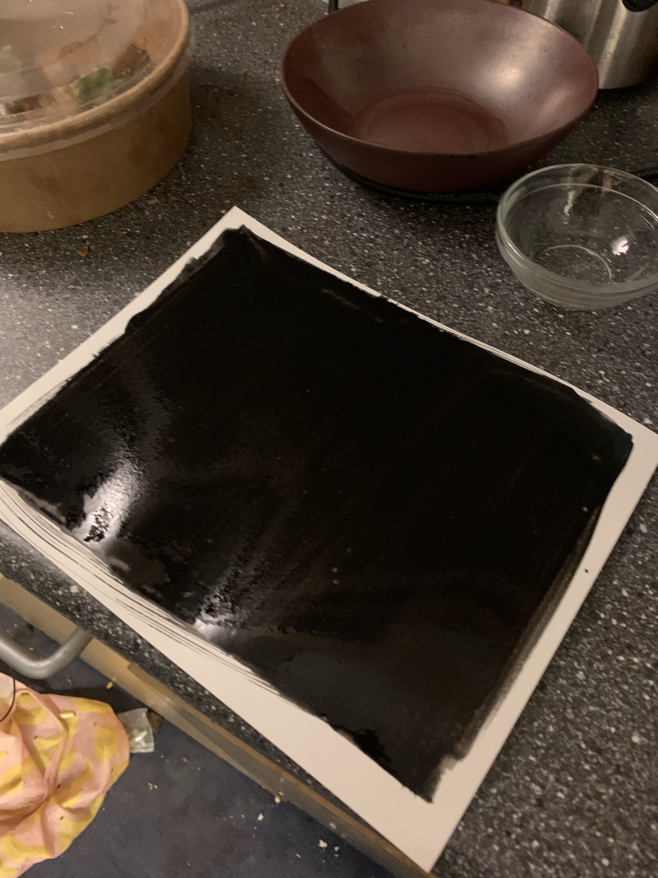

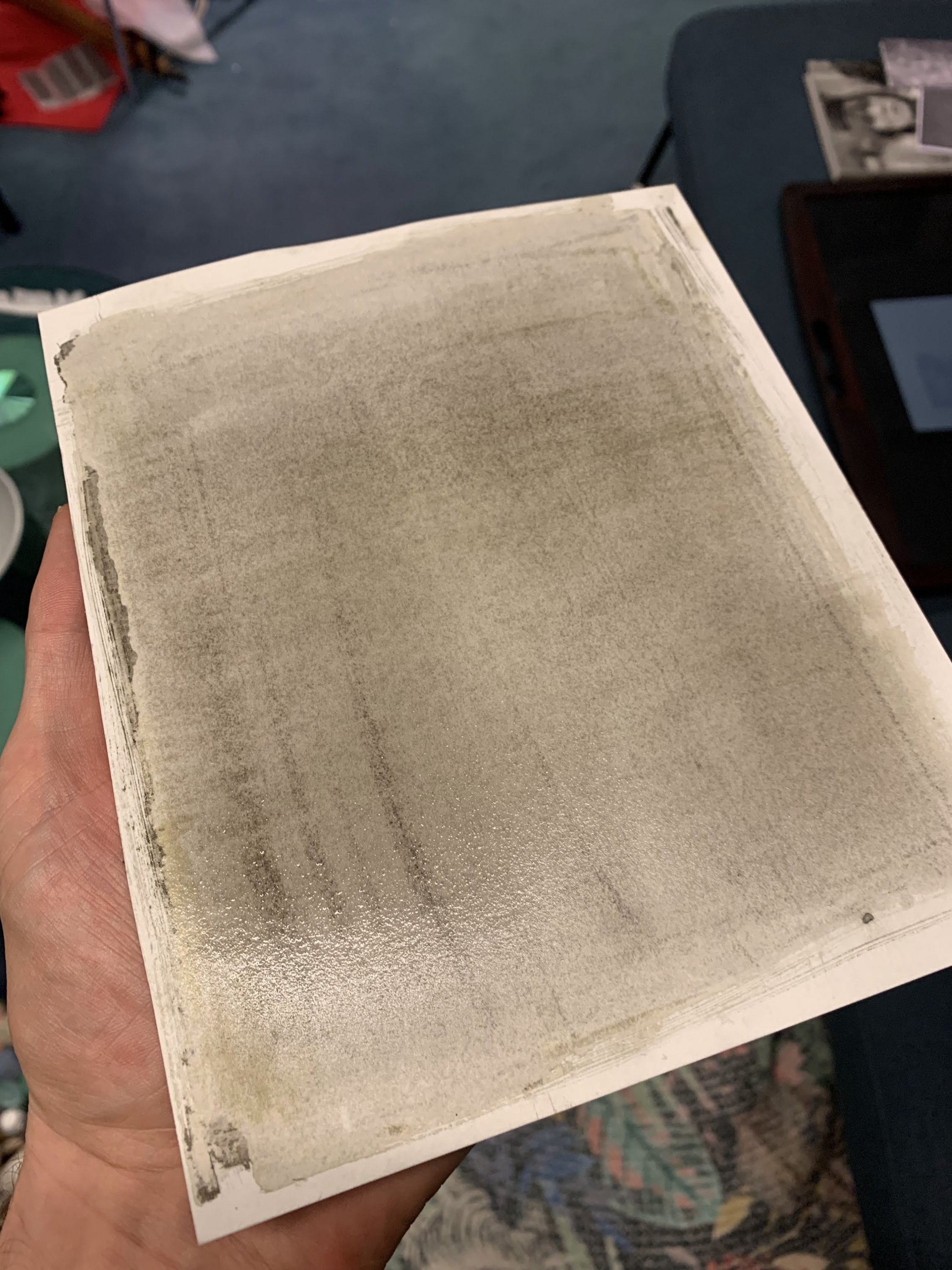

Hi There,
Im trying to catch up on casein printing with das again. However I used a somehow different recipe with little succes so far. Bases on my former succesfull carbon prints I now use as solution of:
50% Casein extracted from milk
44.5% Water
5% ammonia
0.5% DAS
After 3 minutes of exposure in UV light on a light to dark checker box the result seems to be a completely washed out print meaning that the emulsion didn't harden. The same LED UV light source seemed to work with carbon prints so I suspect something to be wrong with the solution either exposure times.

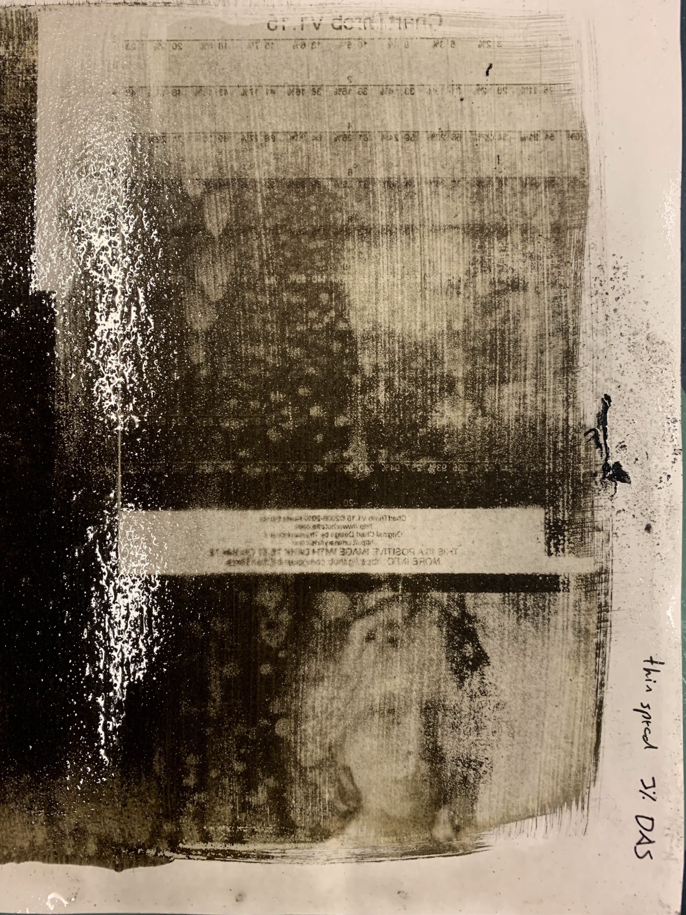

now it looks slightly better, the das solution is raised to about 3% exposure 10 instead of 3 minutes. Although the image seems to be quite crisp in some areas ( small letters are readable now) theres also areas where the image hasn't sticked to the paper. Maybe the layer of paint has been to thick?
