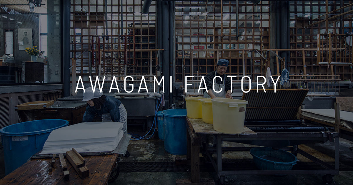

In my rummaging through the Internet researching papers I found this from the Awagami website...
Our most famous paper, Kitakata is composed mostly of Philippine gampi fiber and exudes a warm natural tone. Do not be fooled by imitations - this is the one and original Awagami Kitakata. Kitakata's resilience makes it a worldwide favorite paper for printmaking, drawing, mixed-media, book-arts and alternative photography. Although listed as "unsized", Kitakata's gampi fibers exhibit natural sizing-like characteristics thus requiring no additional sizing
