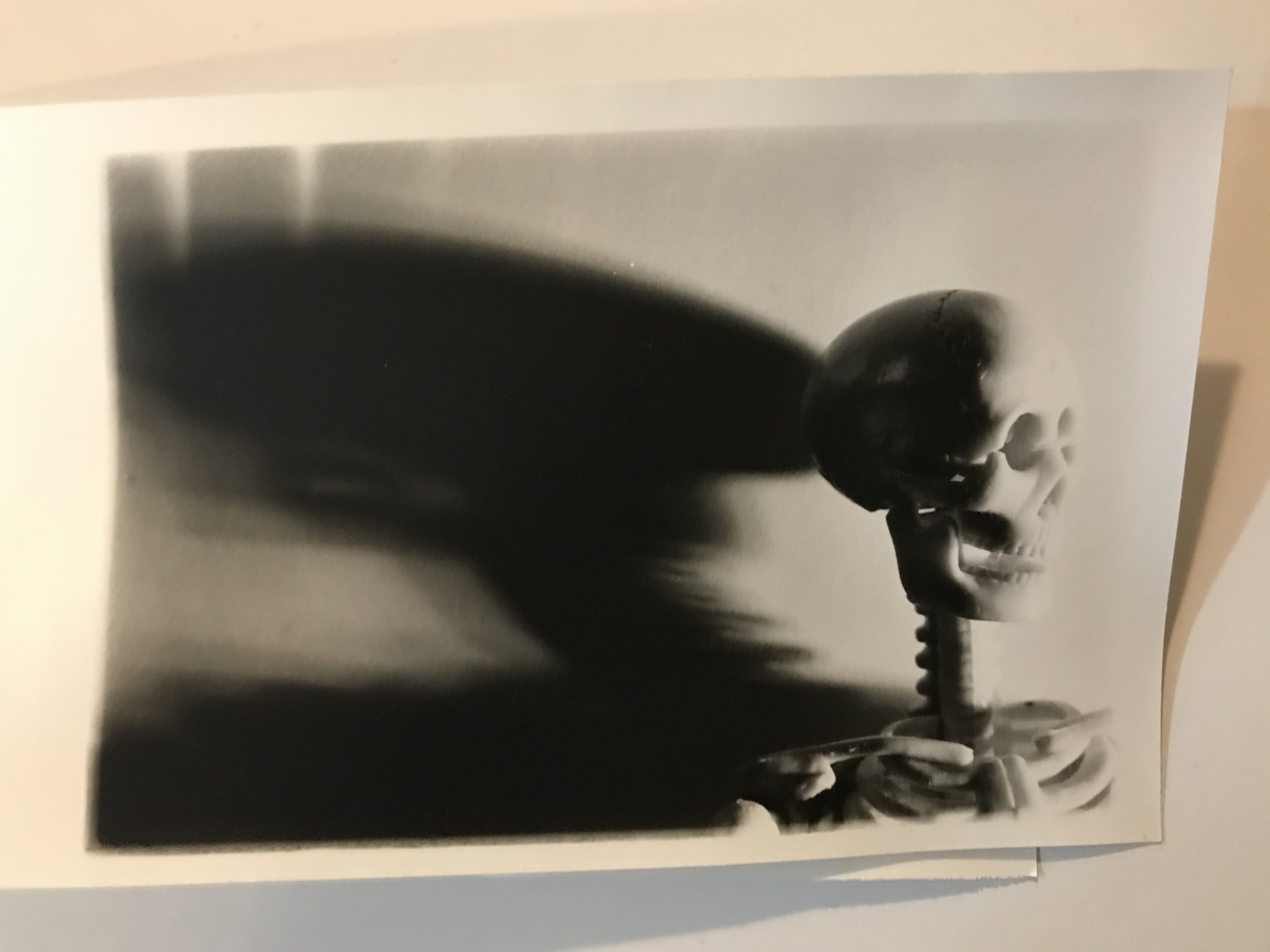

I'm quite pleased with it as a developer. The bromide drag only appears in certain instances. Example:

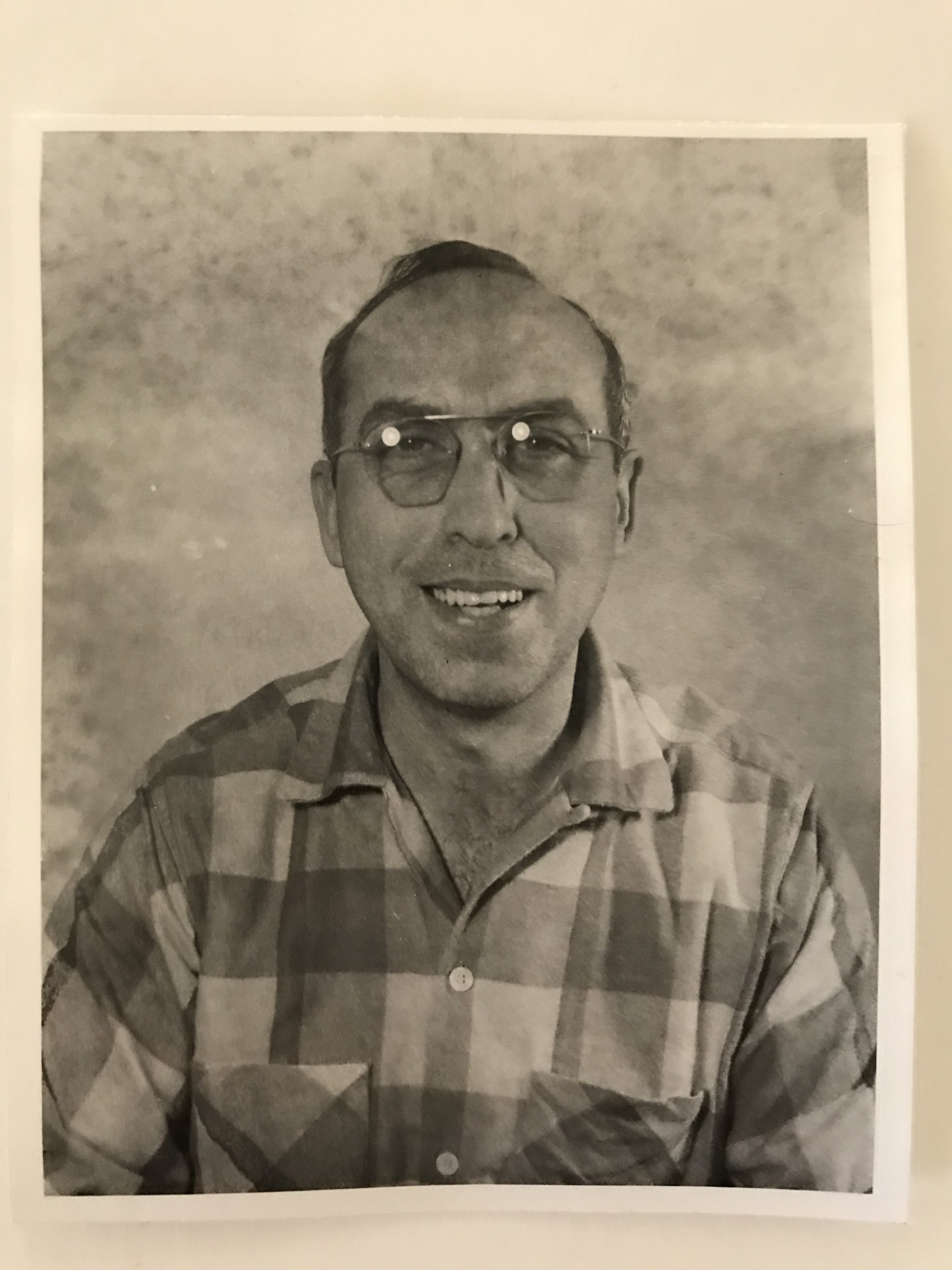

A genuine success of the developer was with a tri-x film pack from the late 50s that was exposed in the late fifties. It was part of a paper purchase and I thought it was unexposed but it had 10 exposures in it. The first ones I developed in d76 didn't fare that well. The ones I developed in this two-bath came out much better. Example:
Of course, the developer doesn't fix degraded emulsion.

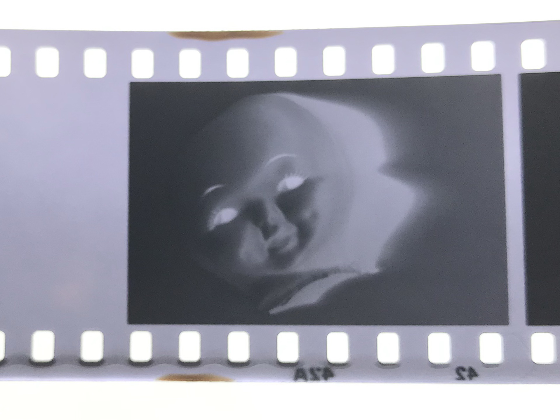

Well, I tested again but with continuous rotary agitation of Bath A and, for Bath B, several inversions at the start and 2 inversions every minute. So, I'm not sure what happened to make my previous negatives thin, since I was certain they were accurately exposed - perhaps I set the timer wrong for one of the baths? This time, no bromide drag.
This is a crop from a pretty blurry phone picture of the negative. 150 watts were shone on one side of the face, casting a shadow across white paper, so there is a good range of tones from black to white. No drag. You may notice two spots that didn't get fixed in the film edge. That's due to my loading film onto the reels emulsion facing out. That prevents any tiny bit of whatever that may get poured in with the developer from scratching the emulsion while the film is rotating in the Jobo. It quite possibly contributes to the bromide drag as well, since developer will bead up in there, trapped against the sprocket holes, and stays there if you don't agitate bath 2 - then kinda runs down the film, adding density as it goes. Or that's my guess.
Anyway, since this film, when developed in d76, has base fog roughly equivalent to what amounts to middle grey, I'm pleased.
