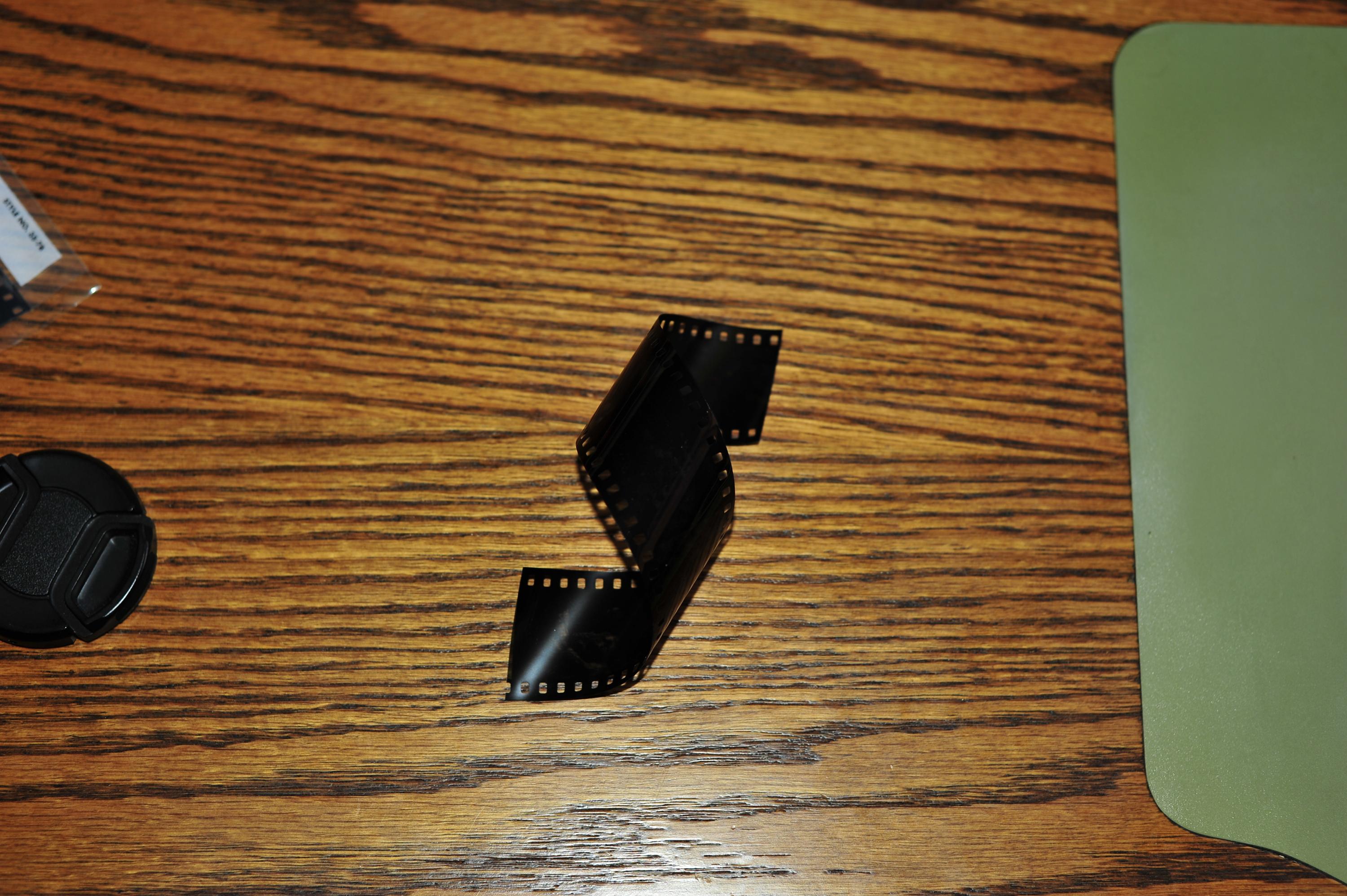

2) after drying and cutting it had a bad corkscrew curl to it.
