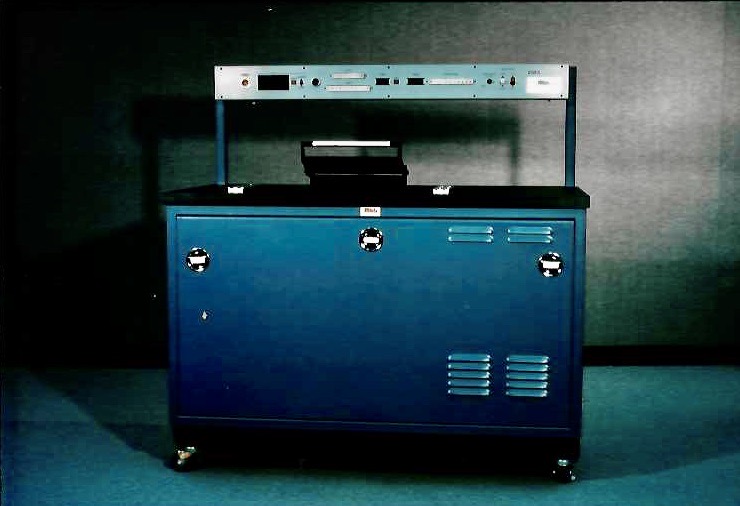

I can't believe I found posts on this subject. I feel like I am in a time warp :smile: I'm a retired photo-analyst who used to design film analysis systems and programs for the govt. and the micrographics industry some 40 years ago. Worked with $ 250K sensitometers and auto scanning densitometers. I wrote software for sensitometric analysis of every kind of film and paper on the planet. Ran many processing and developer studies. I wrote a subroutines to digitally calculate C.I., gamma, fractional gradient point, vertex ratio, Delta X, response at .1 above B+F etc. If I can be of any help let me know.
Below - $250K MTL Star sensitometer. When Kodak wanted to calibrate all their sensitometers they used to call us. Same with the Air Force and other agencies
