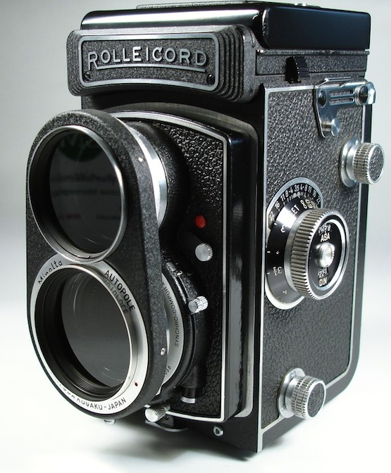

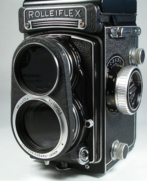

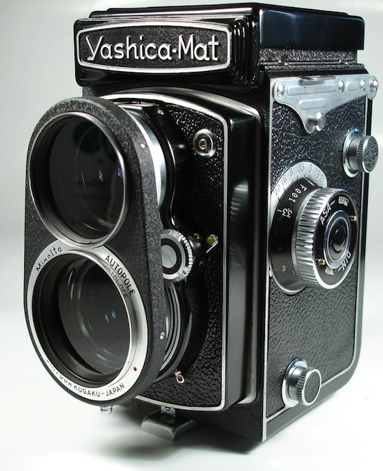

I'm not sure but this is what I found - there are more pictures like those on the web - rangefinder forums has a thread about the theme too.

macfred
Nov 6, 2014
3,839
Germany
Dante Stella reports on his site the Autopole works with his Rolleiflex 3.5MX. On rangefinder forums there is a user who has it working on his Rolleicord Vb with no problems. Maybe Dan Daniels knows about the spacing between lenses.

I don't know hard specifics of spacing between the lenses of Bay I TLRs. Most Bay I TLRs can use the same double lens cap, so that's a good clue.
As I understand the Autopole, it bayonets to the lower lens and in the process rotates in front of the upper lens. So slight variation on lens distance wouldn't matter much?
Thank you, sir - that's what I thought.
