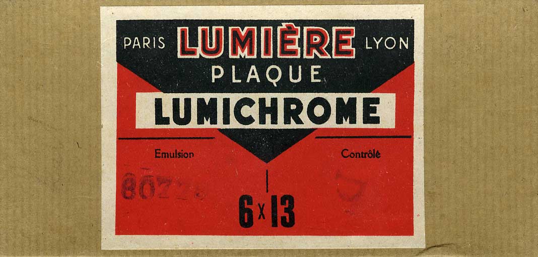

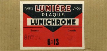

A duplicate of an Autochrome onto a modern slide film which is then scanned gives better results than a direct scan I think.
I have seen slides made from Autochromes and they look better than the original. I have seen 5x7 Autochromes and they look ok, but have a grain pattern and aliasing due to "pixels" just like a digital material only worse.
Here is one part of a stereo pair out of a box of stereo Autochromes. The box scan is also inlcluded.
On the emulsion side, you can clearly see the silver image and on the base side all you see is black when you view the slides by incident light. Looking through them with a loupe you can clearly see the grains.
These commercially produced Autochromes bore the label Limichrome as you can see from the box. They and others that were in the set, were produced about 80 years ago. I bought these at an antique photo and camera show 2 years ago while shopping with Grant Haist and his wife. I was fortunate enough to run into them at the show and ended up shopping with them for a while.
