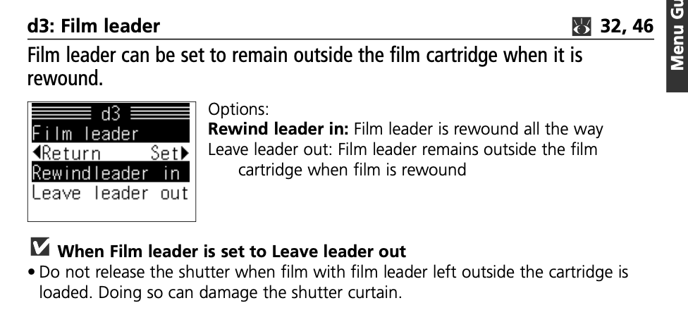

More featured Nikon. I know F6 does it but not F100.
