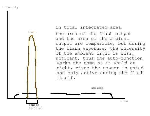

I have figured it out. I wasn't, as Doc Brown would say, thinking fourth-dimensionally.
The flash's sensor evidently only reads during the time that the flash is "flashing". During this small amount of time, the flash's intensity is so much greater than the ambient light that the ambient light is approximately ignorable. All you practical people probably understood that just fine; I just needed it put in physics language. I even made myself graphs:
