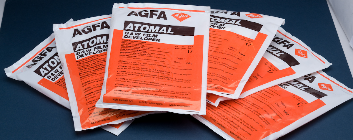

If anybody has craving or desire to try Original Agfa Atomal from one of the last batches, please let me know. I have 5 or 6 - bags of powder to make 1L.
