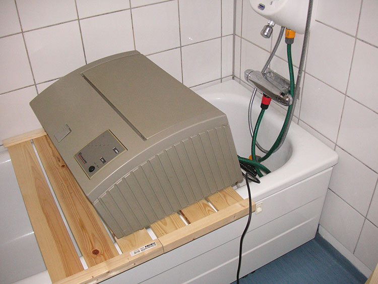

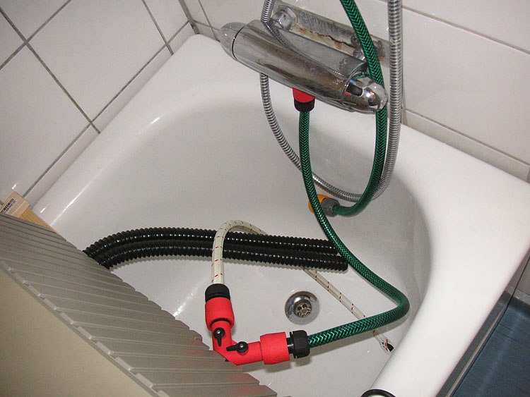

I set up my ATL-1000 in the bathroom just before using it. It takes me about 5 minutes to set it up. The machine is connected to a thermostatic shower mixer which does a good job at controlling the water at 38 degrees C for E-6 and C-41. My shower mixer doesn't do as well for 24 degrees C, but I prefer to develop BW by hand anyway.
I have attached a Y-connection (with built-in taps) to the Jobo, which allows water to trickle through the hoses. This way, the water in the hoses doesn't cool down before the machine actually starts washing.
The ATL-1000 is the same as ATL-1500, but the latter is programmable.
Please see the atteched snaps.

Trond thanks for those images... pictures worth a thousand words!!! This seems feasible and would work with my laundry sink I believe. I've one spicket that both hot/cold water pours though, and I have the spray/hose also mounted on that sink... so thinking I'll need a way to regulate temperature and gives me an indication of the temp. Can you tell me where you found the y-connector with the taps, and does it have the european to u.s. adapter connectors? These I'm having a hard time locating
thanks again for taking time to help ! jeri ann

The way I set the temperature of the incoming water is to set it at 22-23 deg for B/W and at 36-37 deg for E6/C41 work. The machine will then heat the water to temper the chemicals to 24 or 38 deg. There should not be any problems with pre-washing and final washing at a degree or two off the developing temp.
Second, the Y-connector shown in Tronds excellent pictures are part of a garden hose system. In Scandinavia they are called e.g. "Gardena". That particular coupling should relieve you of some $20 or so.
