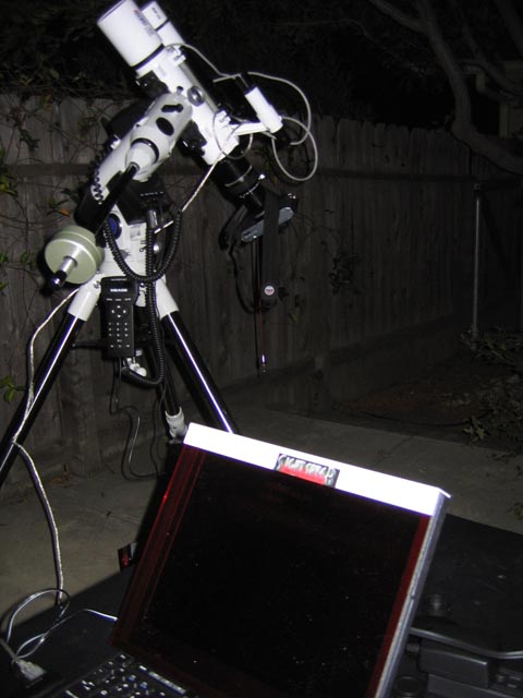

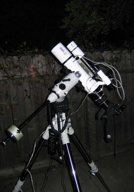

I've attached a picture of my setup getting ready to shoot the Leo Triplet of galaxies (35 million light years away). The best films for astrophotography are Elite Chrome 200 and Fuji Provia 400F. Provia is better for galaxies and Elite Chrome is better for nebulae.
