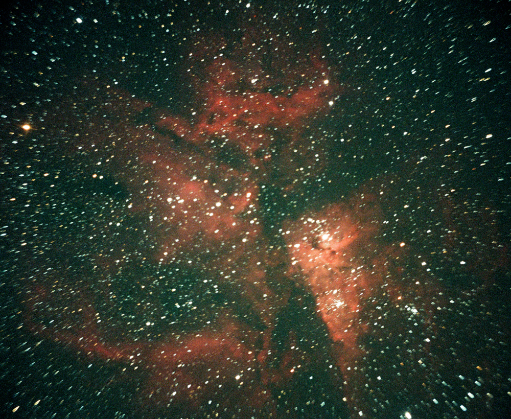

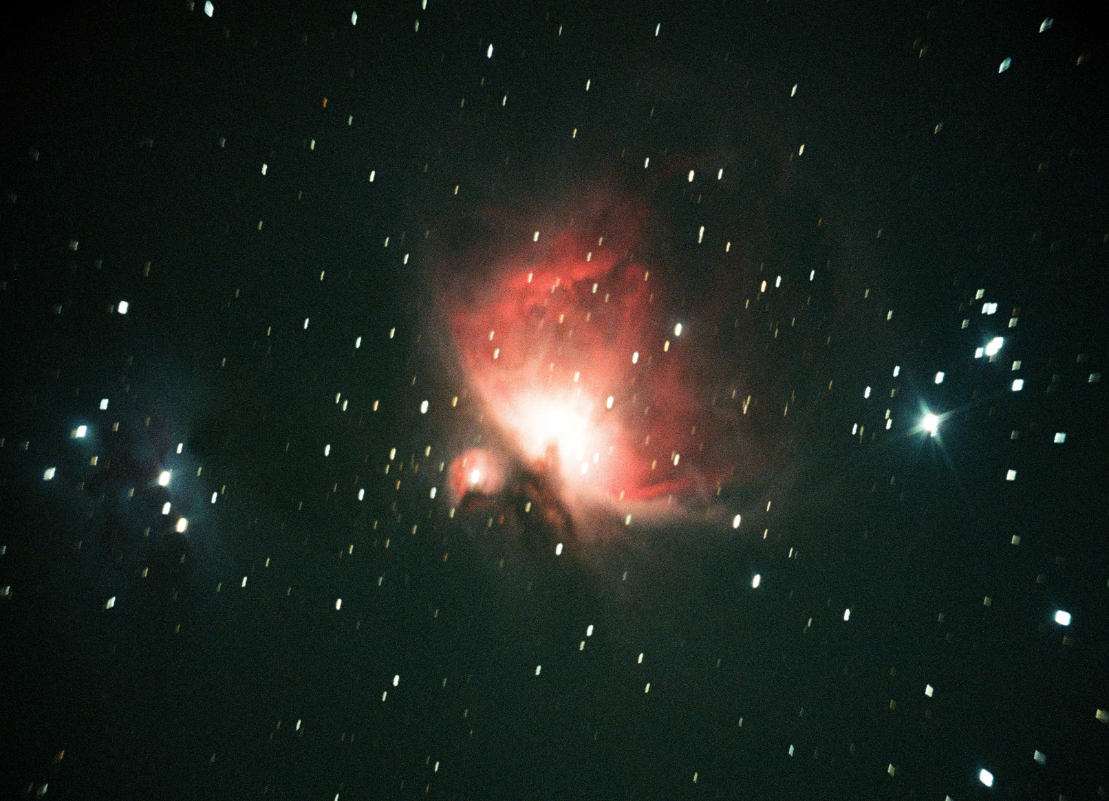

First go the other night and I think I see enough here to try for better. 30mins on Orion and Carina nebulas, the two brightest that I know of.
My coma corrector spacing is a looking way off, so much so that I think it did more harm than good. And it looks like the mount suffered some jitters, but I think once coma is accounted for the images will be much stronger. orion tinier.jpg carina crop and levels smallerer.jpg
