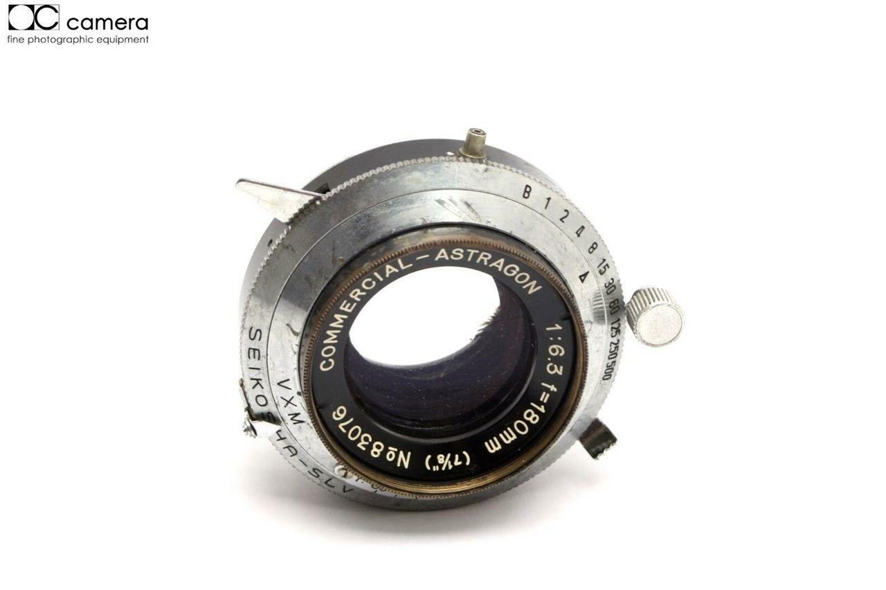

"Astragon" on the cap might mean that it is an Astragon lens, but most lenses are marked somewhere with a name or serial #. Pictures would really help.

Here's the answer. Is this what you have:

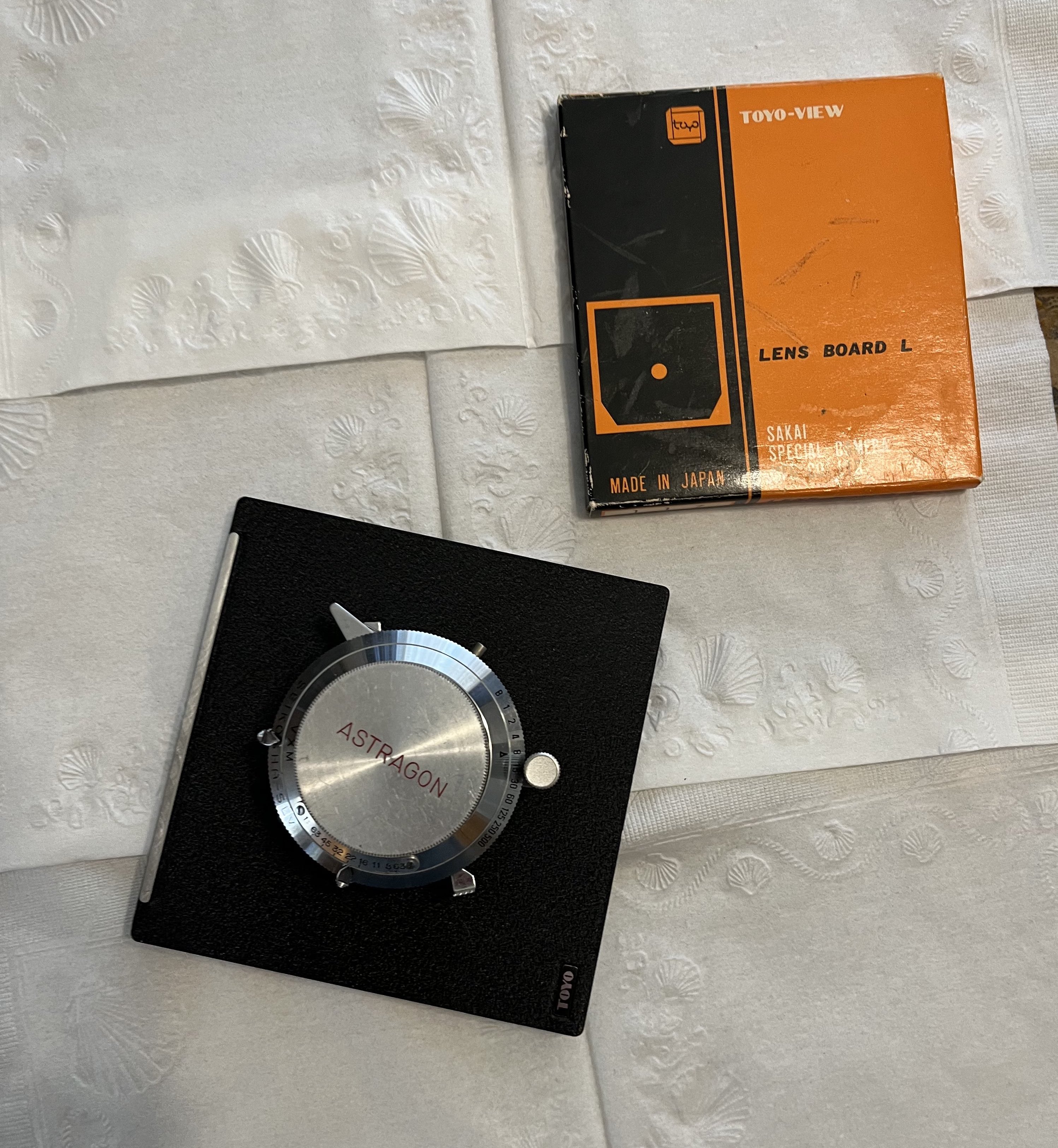

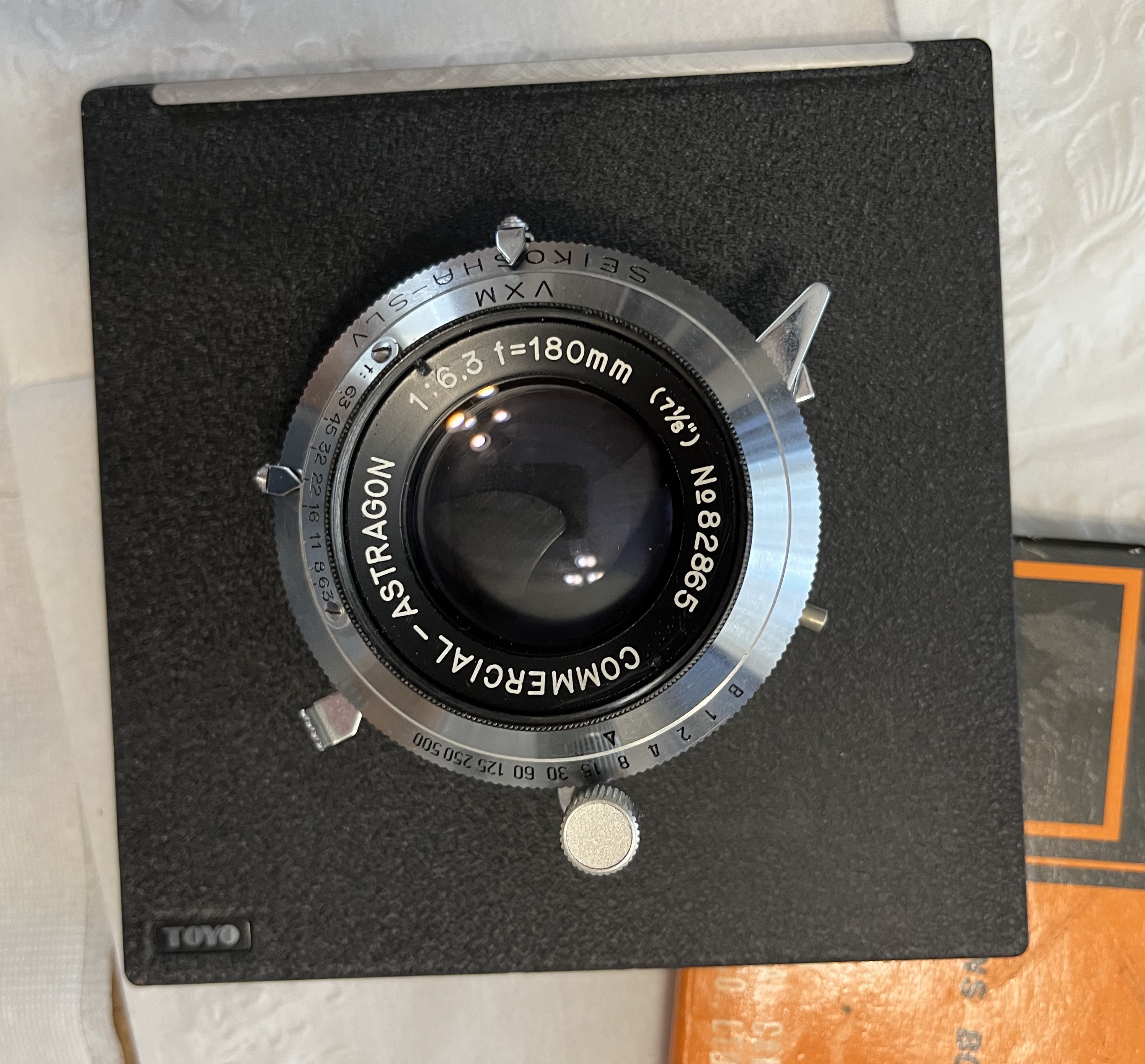

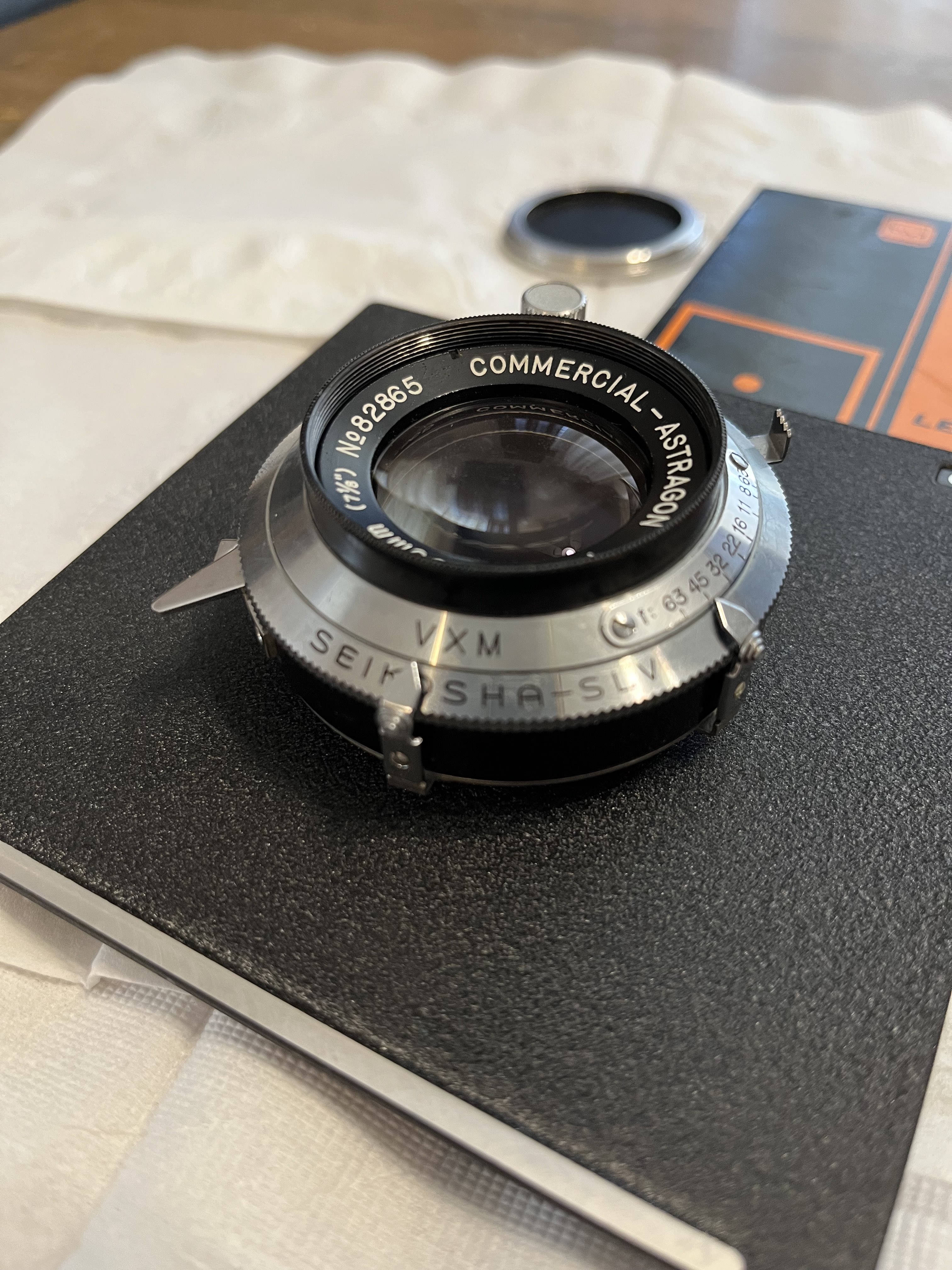

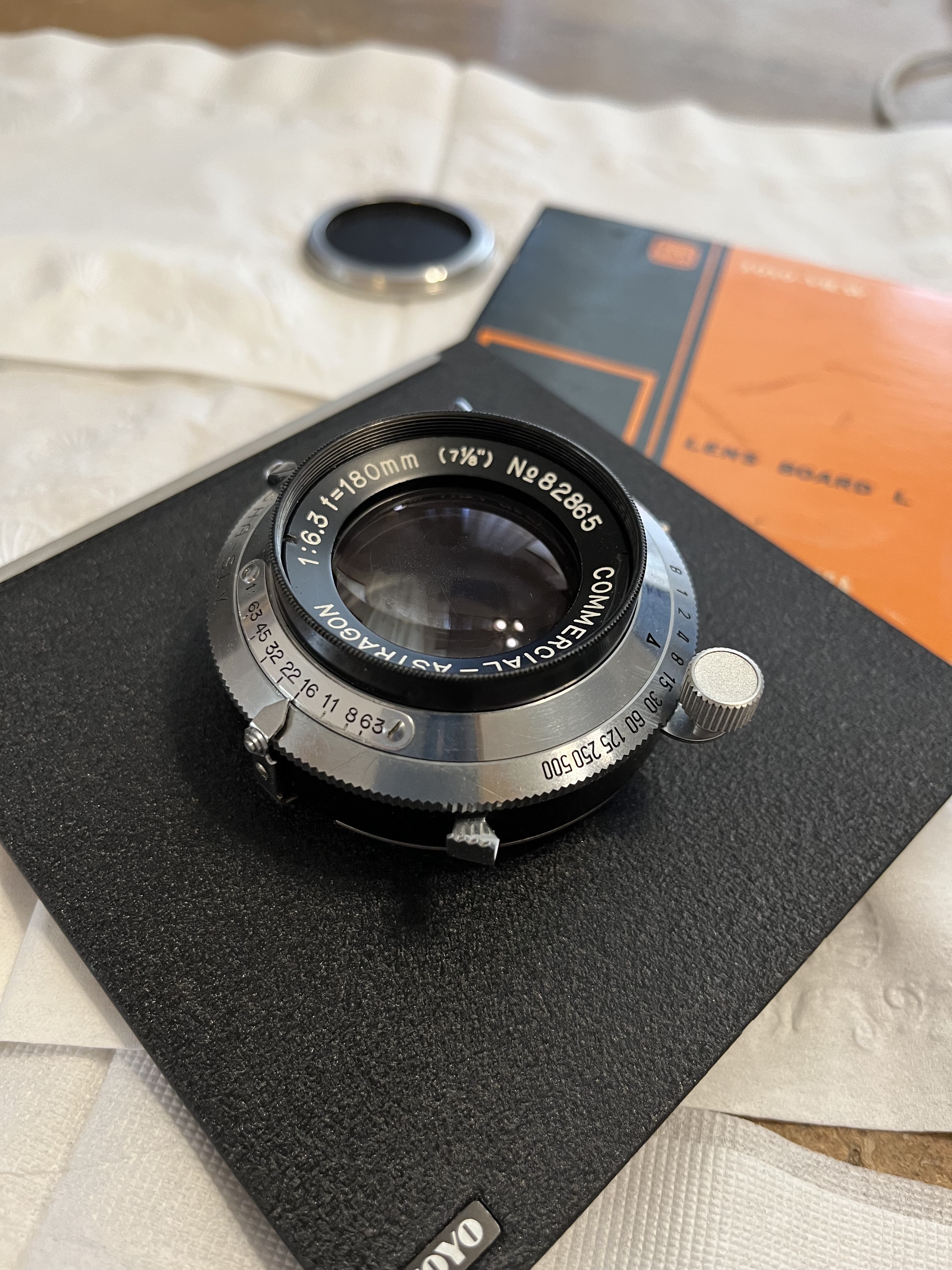

Where are the pictures? Right here!
Note that I don't actually know how to operate this lens, so... just trying to figure out what I've got here.
Edit - yes, I do. Works like a Copal, it was just sticky at first. Worked it very gently, realized which are the cocking knob and the shutter release, and tried it out. Shutter speeds seem to progress about right (I can test later, once I get my Photoplug from Filmomat working) and the aperture stops down correctly.

That one looks almost mint. BTW for selling the lensboard with it's box might get you $30 by itself if you separated the lens from the board and sold them separately.

Dad did always take very good care of his photo gear. That, I learned from him.
And it turns out that's not the right box for the lensboard - not sure which one it goes with, but the board that lens is on is larger than a Type L. If I do have the one for that box, I might could bundle them together.
Not sure I want to get into selling every single bit as separate pieces, though.

Works like a Copal? Not exactly.
Works like a Copal? Not exactly. The tab sticking out of the shutter at ~ 8 o'clock will open the shutter for focusing. To use it, cock the shutter and pull the tab out. To close the shutter, push the tab back in. The shutter will stay cocked, ready for shooting.

its kind of weird how the smallest aperture on the aperture plate is ƒ63, not ƒ64. so it threw me off at first glance because one side is ƒf63 (with the period not printed) and the other side is ƒ63.
